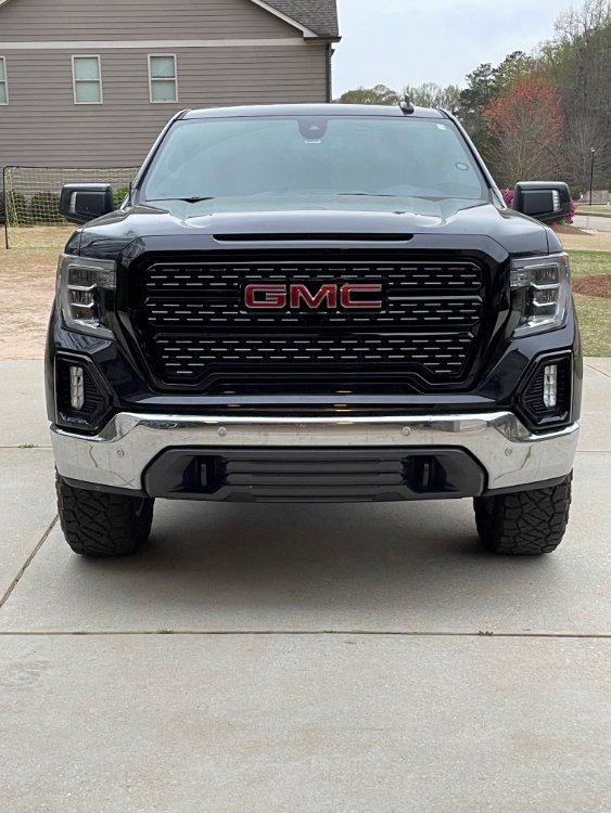

  2. Well I was driving home the other day and saw my trucks reflection and noticed that my passenger side DRL finally has failed and turned purple also. So now both my lights match at least

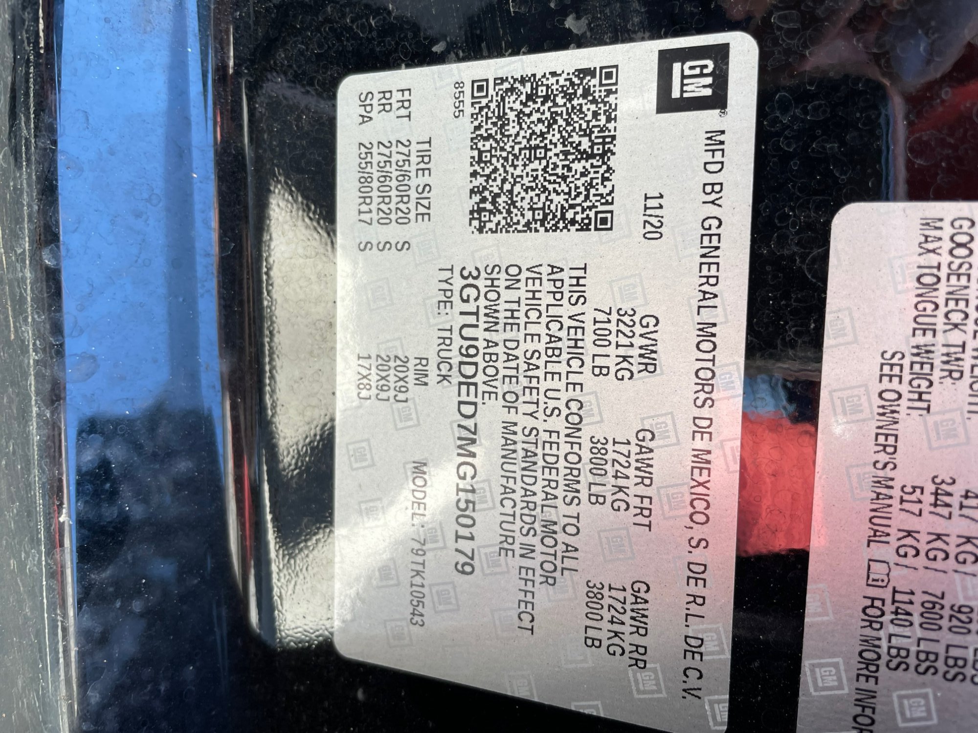

  8. Ahhh... thank you. I'll locate that sticker today or tomorrow and let you all know.
  9. Is it just me, or is there not a date shown there? If not, how do you interpret date codes?

  12. Yep, found it. Thanks. Looks like my build date is also 11/2020... so you and I are in the exact same boat. As far as demanding they replace both sides, that's going to go nowhere. That would mean the dealership would be taking around a $2000 hit. I actually just got back from dealer again today. I had them change the oil (they were supposed to when lifter was replaced) and look at why the truck is now idling rough after they replaced one bank of lifters. The shop foreman drove the truck, acknowledged that it does idle rough. He wants me to drive it 2,000 miles first, since it was a major repair, and see if it still persists. If it does, they are going to look into it further. We all know it's not going to correct itself. So, I will be taking it back in 2000 miles from now.
  13. Where is the build date listed? I looked around engine bay. I see dates on individual parts, they all vary. Looked at paperwork on truck, didn't see it there.

  16. That’s a good point. I noticed the other day when I remote started my truck, it turns on the DRLs at the same light level as when the headlights are on. I also noticed that my drivers side was not purple at all. Once I actually pressed the start button and the truck was fully up and running, the DRLs switched to full power and then my drivers side turned purple.
