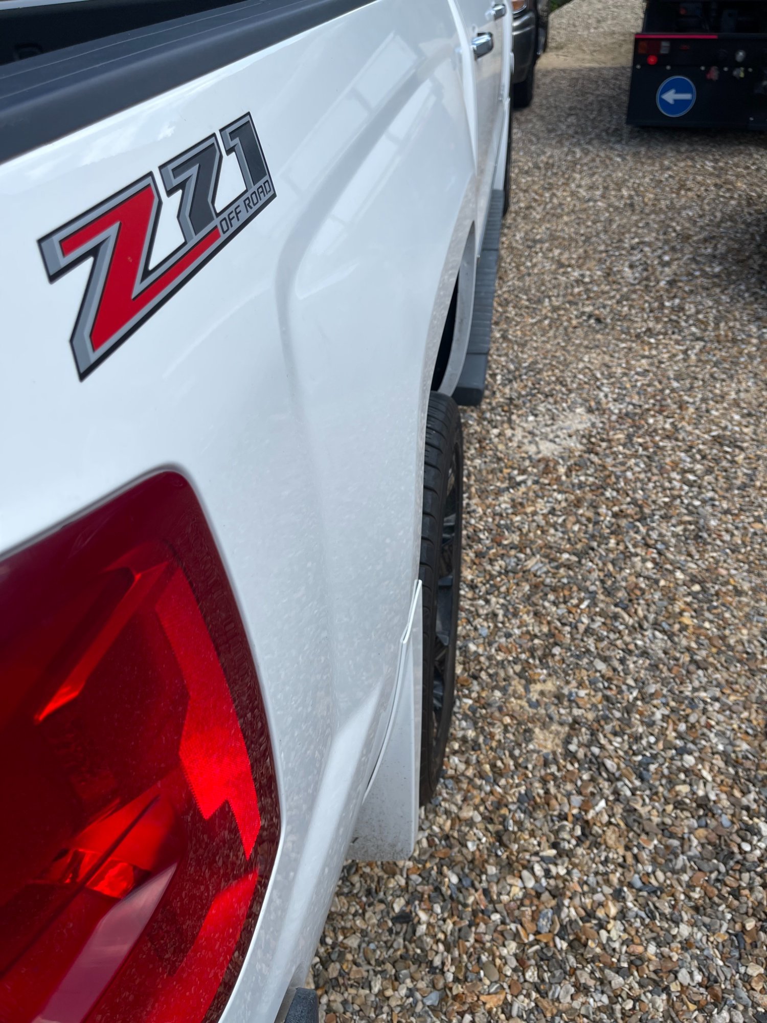

  3. yes the left side sags and the front a little too on the other hand as soon as we put a counterweight at the right rear to balance the front of the truck is in line I think it was badly strapped on everything the left side I will already repair the blade problem to see the correction on this model we can not cheat by adjusting the torsion bar there is none

  8. I believe that during the trip from Canada to France when they were strapped, we had to strap it very hard on one side which crushed the rear left suspension blade
  9. Hello I am French and I have a very poor command of the language I am bored with my silverado of 2016 crew cabin LTZ here is my rear bed leans almost 2 inches I am attaching pictures to you. must we realign the suspension blades ?? should we change them ?? what is the problem? the chassis leans on the left side front and rear when I but the weight at the right rear the front becomes normal I noticed a significant gap on the last right suspension blade I will tell you but some photos can you give me a solution thank you to all of you
