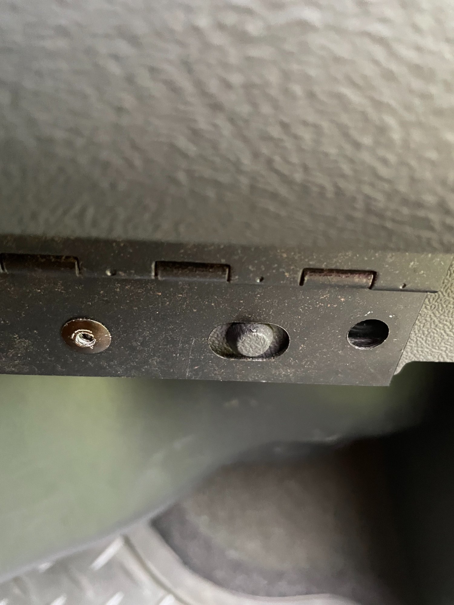

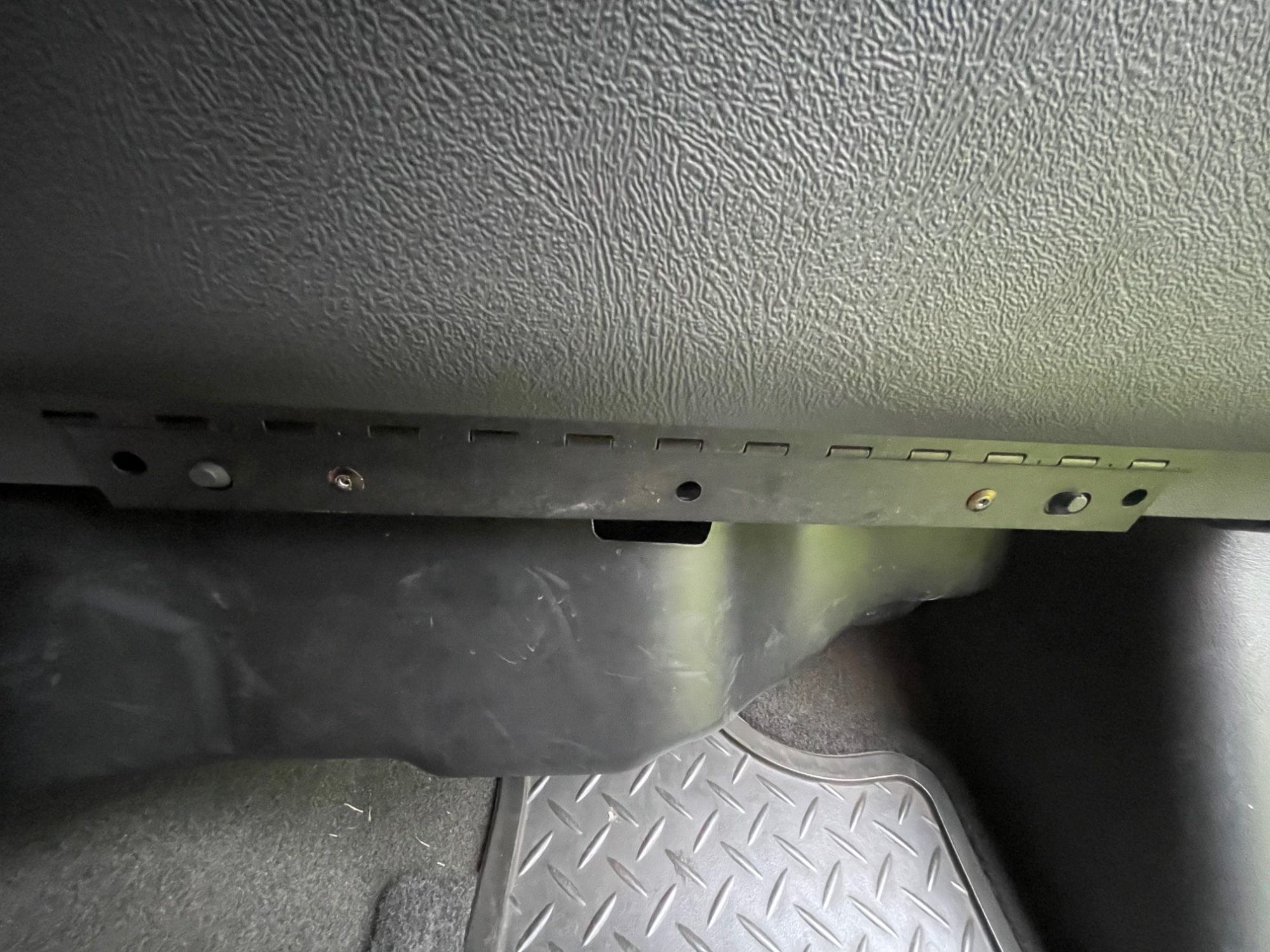

  1. Thanks everyone for the feedback. I used a 1/4 drill bit and removing the rivets took less than a minute. New box has now been installed.
  2. The latch broke on my glove box door so I ordered a new door. I attempted to remove the old door to install the new one. I removed the 3 hinge screws at the bottom of the old box and encountered 2 tethered bolts still holding the old box hinge to a plastic strip and is part of the paneling. I need advice on how I can remove these two hinge bolt attachments without damaging the plastic strip they are tethered to in order to completely detach the old box and install the new one.
