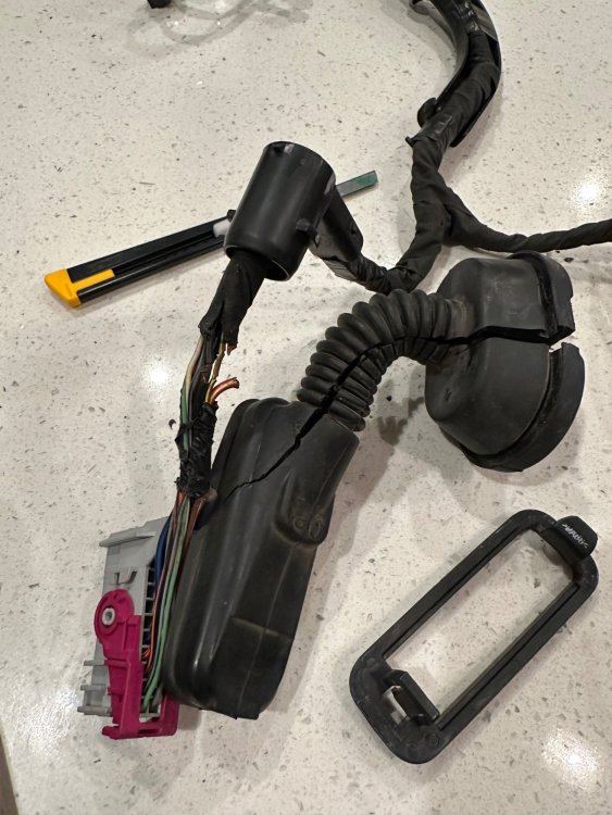

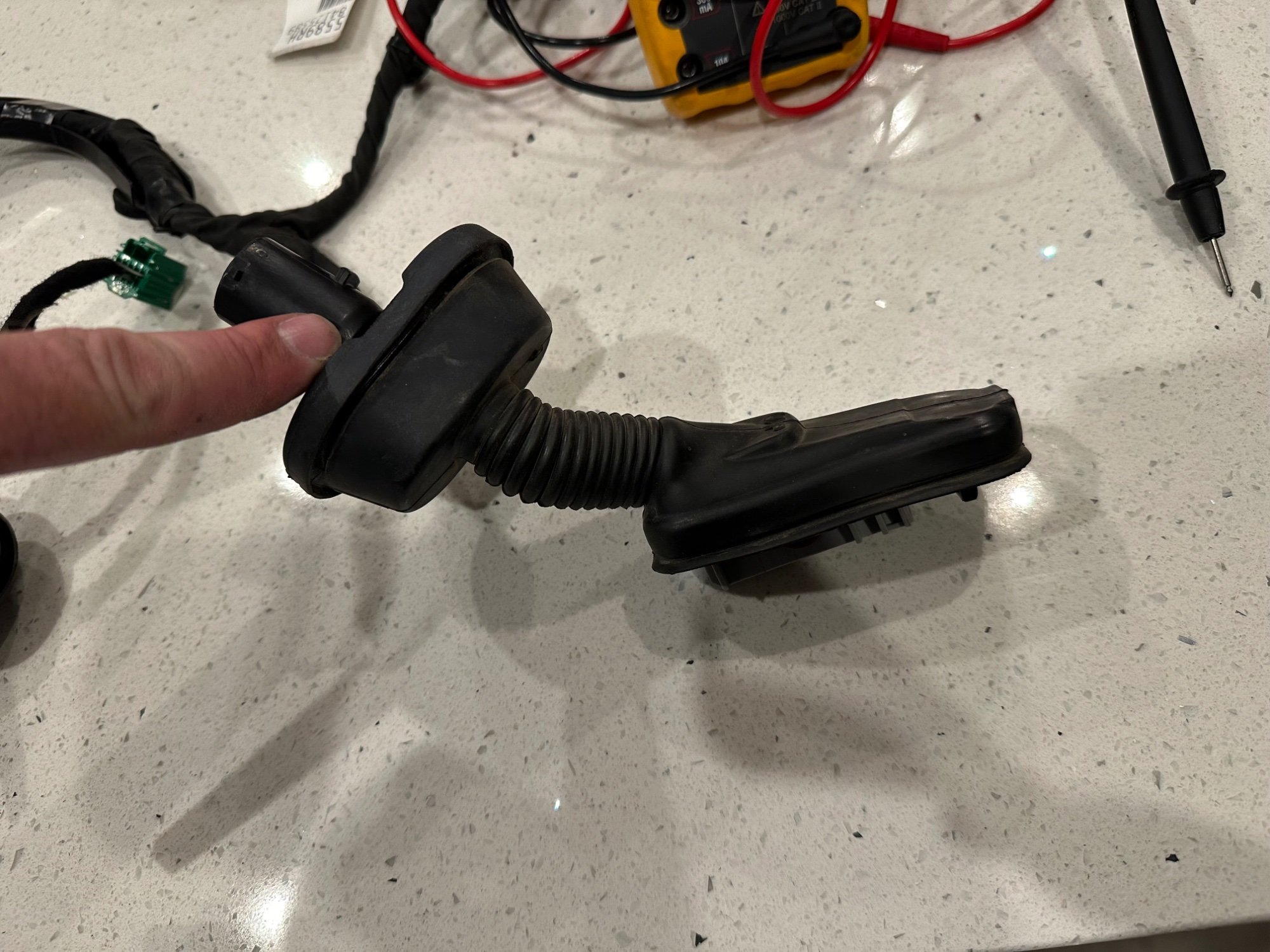

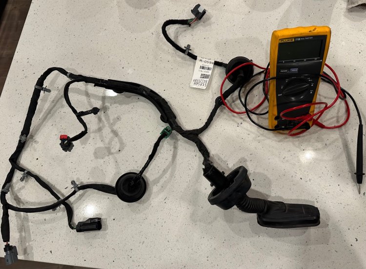

  1. FOUND IT So since my passenger/right rear door was the main problem child, (window not working and door ajar) I decided to deep dive into that door. I removed the door panel, disconnected the accordion from the pillar, disconnected all plugs from locks, window button, speaker, crash sensor, etc. and I pulled the entire darn harness out of the door completely. Quick inspection of the overall harness… looked great. Then I said screw it and I cut the accordion boot clean off, then cut the tape that the wires are wrapped in underneath that same boot. BAM! The wires were soaking wet (it hasn’t rained here in weeks), broken, and corroded. Looks like I’m headed to the stealership tomorrow for new harness. I’m an avionics technician so I would just repair those wires… but I had a fit of rage and cut the boot off. Damn.
