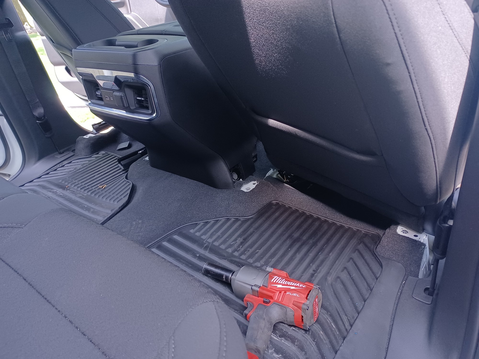

  1. the antenna for the door locks was near the rear usb the key fob antenna was towards the center of jump seat. its a circle cone looking thing with a wire coming out of it. that gets mounted under the center of the middle try. the other is by the usb's in the back.
  2. So i just did this swap on my 2022 2500hd, I had the center bump seat with the storage underneath, rear vents, usb, and 12v power. After looking for a used center console that was not scratched or cracked, I found it was cheaper to order the parts and build it myself. All the parts together ran around 1050 shipped from https://www.gmpartsbin.com/ now i live close to them and the crazy part is to walk in there i was close to 1400, went on there website and had them shipped to my house 1025, Anyway my only suggestion that i dint see on this forum is to remove you fob antenna and board, and the keyless entry antenna out of your original seat. the rest was pretty smooth. I would also skip the 2 items on my part list with lines next to them and just use the usb thats in the dash. If anyone is looking for a black jump seat with storage compartment with about 1000 miles that no one ever sat in let me know.
