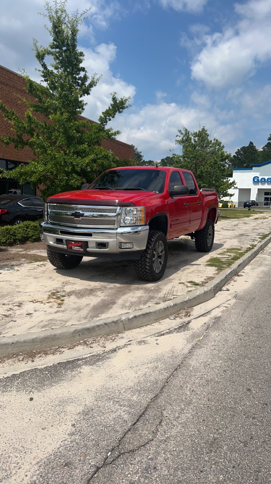

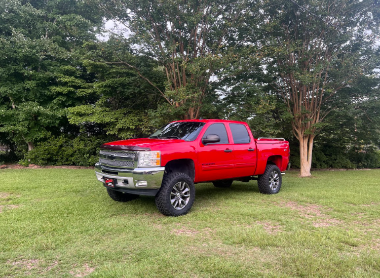

  3. I currently have a 2013 Silverado CCSB 5.3 2wd with a 6.5 inch zone lift kit on 2020 Silverado 20 inch RST Wheels mounted on 35 inch trail grapplers! I currently have the crappy factory 3.08 gear ratio. As you can imagine, a truck with 35's with a 3.08 is an absolute dog! Holds gears until 2500 RPM, 6th gear is totally unusable over 60MPH, and 9.5 AVG Fuel Economy. AFM/DOD has been removed from the engine also. When I first bought the truck in July 2021, it was a mostly bone stock 1 owner truck. It had the 17 inch alloys on 265/70r17 Goodyear wranglers on stock suspension. RPM's were relatively low with the 3.08, but of course, mostly stock! Averaging 13.2 MPG I've recently have had to do some long distance driving & the low MPG + price of fuel is costing too much! For anyone that has knowledge on this, do you think it's possible to put a 3.73 gear ratio in with a 6L80E & 35s, and have lower RPM's, or is it best to go for a lower gear ratio like a 4.10+ ?? I'm just trying to get as much fuel efficiency as possible! Any input would be great! Thank you

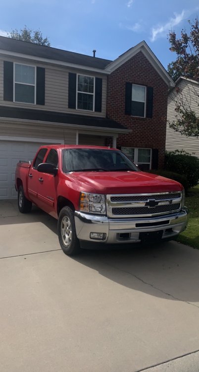

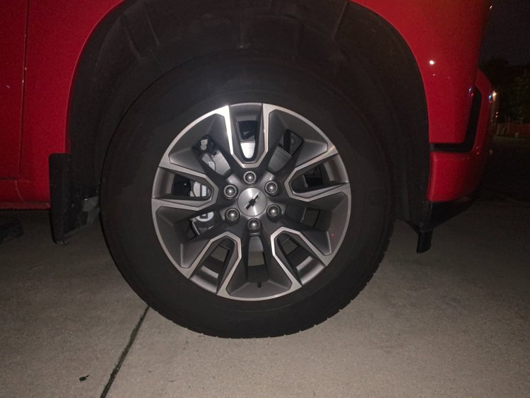

  7. I recently bought a red 2013 Chevy Silverado, I love the truck, but theres some things I wanna change on it. My neighbor recently bought a 2020 Silverado RST. He is selling his wheels, they are the gray 20 inch RST rims. I would like to replace the 17 inch alloys anyways. Since I plan on lifting my truck 6.5 inches. Do any of y’all know if a 35x12.50R20 would fit on the 20 inch RST’s?
  8. I know I have a older truck than y'all but I recently bought a Red 2013 Silverado LT CCSB Z71 2wd. My neighbor has a 2020 Silverado RST with the 20 inch Gray RST wheels. He said he'll sell me the rims. I want buy them so I can get off of the ugly stock 17's the truck came with. I want to do something different than everyone else. do any of y'all know if a 35x12.50R20 would fit on the 20 inch RST wheels? I also planning on putting a 6.5 inch superlift on it so I'm not really worried about fitment.
