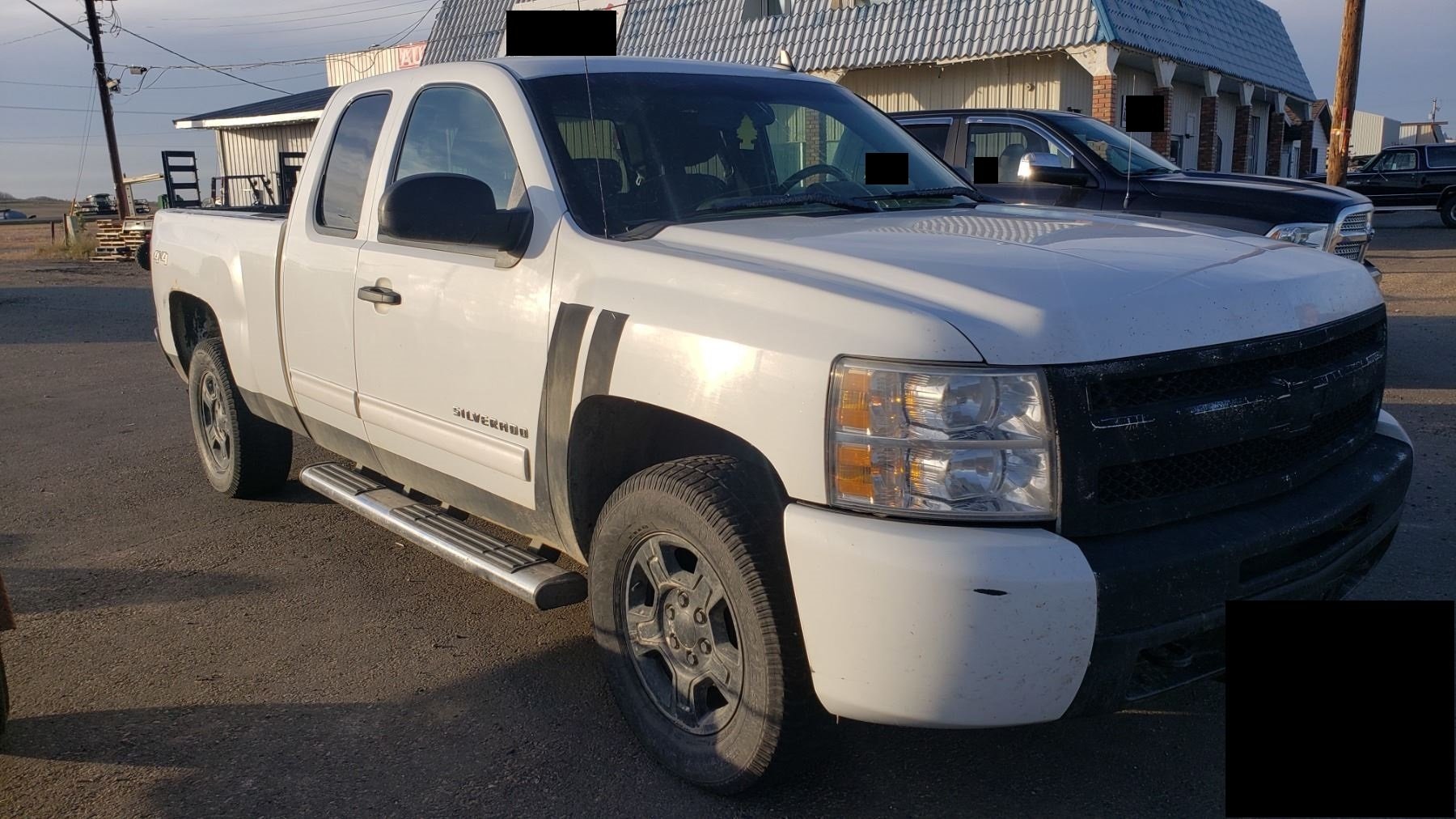

  5. Here's some pics of the truck. It's the auction pictures so I blocked out the watermark.

  7. Hey all, first time poster. Recently picked up a 2011 Silverado 1500 5.3 4x4 with 250k miles real cheap from an auction. Overall it's runs and drives great, no engine ticks and shifts great during a quick test drive. I gave it a quick once over and it seems to have been neglected a bit, fluids are quite dark all around and a laundry list of minor repairs to do. It does need some big ticket items such as tires, windshield and a steering rack(leaking out the boot). Im planning on changing all the fluids, filters and maintenance items starting with engine and trans. I understand I definitely am taking a risk on this truck so I want to ask you all what are somethings I should look into or consider before I sink too much money into it
