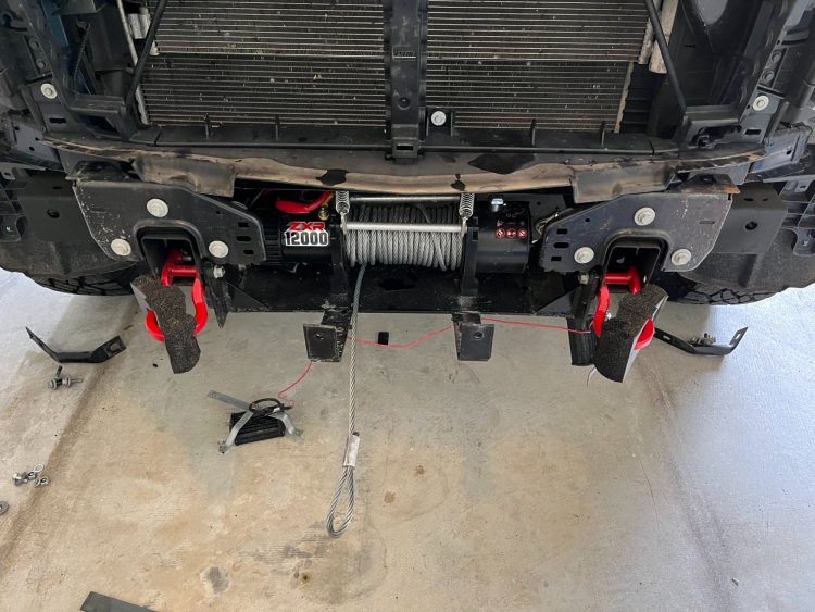

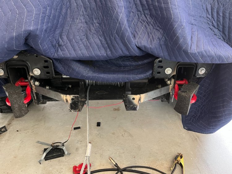

The original mount was a little weaker than anticipated so I went ahead and added some new supports. Fairlead is much stiffer now. -

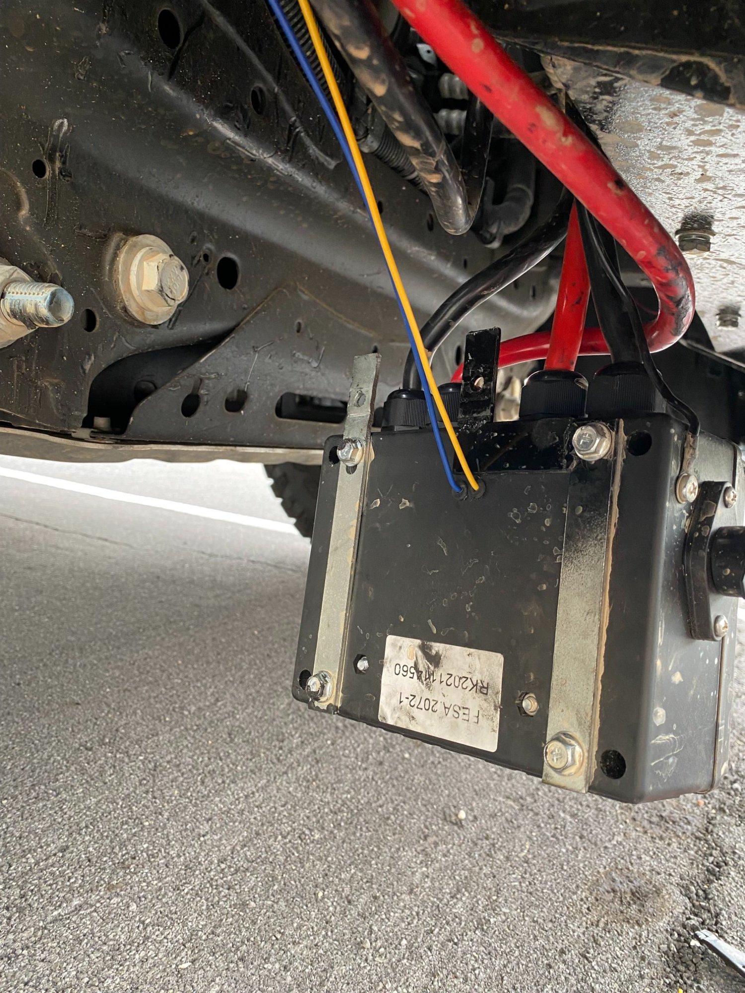

Finally got around to wiring the winch into the cab. I just spliced into the wiring in the solenoid box and added a couple of grommets as shown in the picture. The arm switch for the winch is the switch for my amber fog lights since I ran out of switches and figured that I'd have those on while winching anyways. This let me keep the option to plug in the normal remote and run the winch outside the truck as well. -

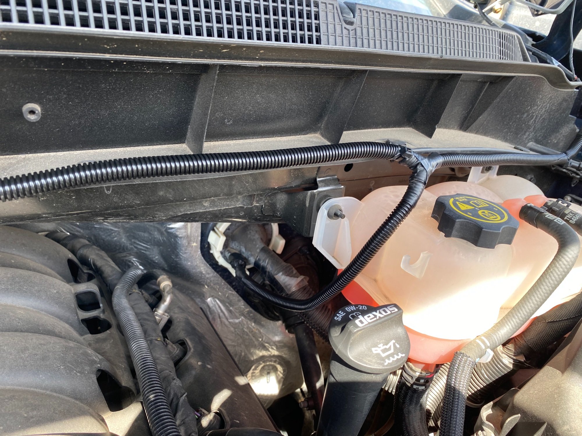

Had some time today to clean up the wiring, here’s a great spot to get wires from the engine bay into the cab I wanted to share. Just have to cut a hole in the rubber grommet then I taped it to the corrugated wrap really well. There is another one just like it on the passenger side too. Also decided to wire the winch into the cab on a rocker switch instead of a wireless remote, will post once I get that done. -

Also, the solenoid pictured is for a power inverter I have mounted in the tool box in the bed. The other small wires are for some fog lights and ditch lights. I made the mounts for those as well and can send pictures in case anyone is curious about those. -

That mount looks awesome! I searched for a long time and did not see anything for these trucks. Let me know if you want to see anything else about the wiring and I’ll be happy to take pictures.
