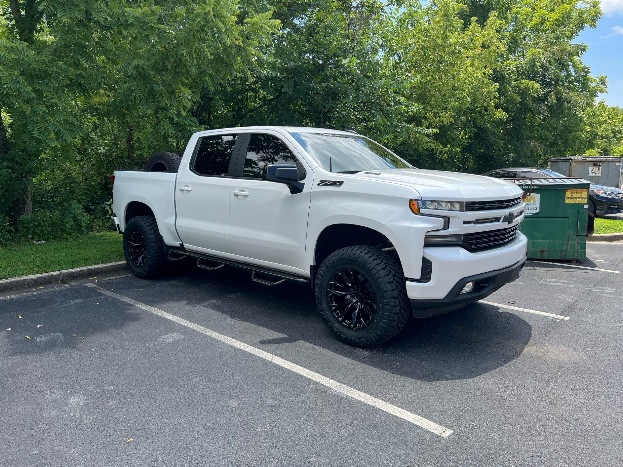

  16. Again will not post vertical. Fuel Vapor 20X10 -18MM offset Nitto Ridge Grappler 35x12.50
  17. I cannot get this picture to post vertical. Sorry about that. Fuel Vapor 20X10 -18MM offset Nitto Ridge Grappler 35x12.50
  18. I am going to post this in three pics... 3.5 Rough Country lift Fuel Vapor 20X10 -18MM offset Nitto Ridge Grappler 35x12.50 Hard to see at first glance but the RC Grille lights are in also... Coming along.

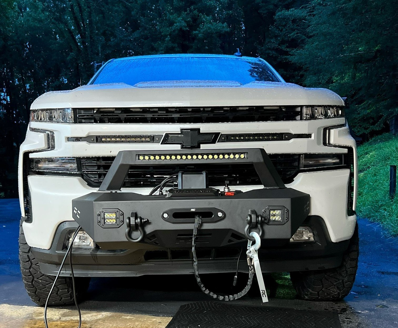

  19. Been a bit since I have updated. I currently have been doing work underneath the vehicle. Airbags, compressor, aux fuel tank connection etc... Today I am putting in the Rough Country grill lights.

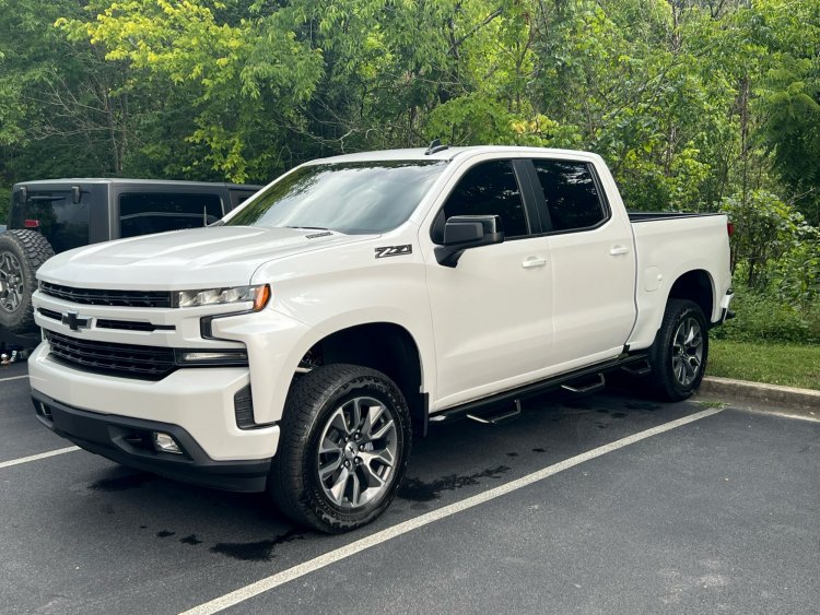

  23. Alright, day 4 of my slow build... Today I have finished the NFABS, 3.5 RC lift, and the Airbags RC are installed as well. Not pictured is the wheel well toolbox, it is an Undercover brand BTW, with the new locks to keep it from being stolen. Badges are replaced from chrome to black along with the windows that have been tinted in addition to the front windshield with 50% all the way down and 5% brow across the top of the glass. Waiting on the winch mount from RC to come in which has now pushed it back to 7/14/2022 according to my order status. This weekend I am hoping my upfitter switches come in so that I can install the grille lights as well as the switches. Wheels and tires should be here by the end of the week. Right now, my truck has definitely missed leg day at the gym.
