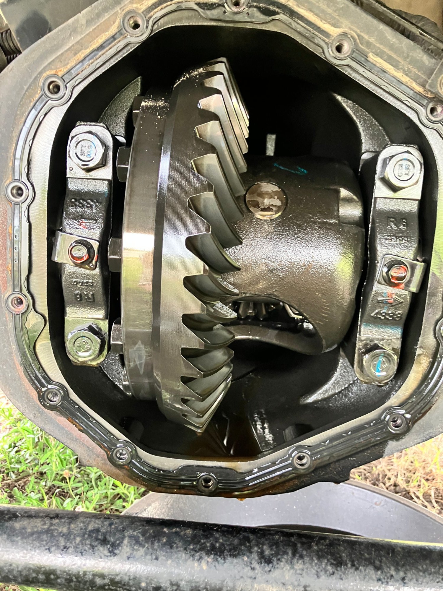

  9. I bought the truck new in December 2022, and it's got 60,000 miles. The front cover magnet had slightly more glitter, but overall very clean, no off odor, and good-colored; really nothing to report. My truck has Hi-Lo transfer case, and the fluid looked great, as well. I have towed..maybe 1,000 miles. Yes, this was the first change for all three driveline items. I'll probably do the transmission at next oil change.

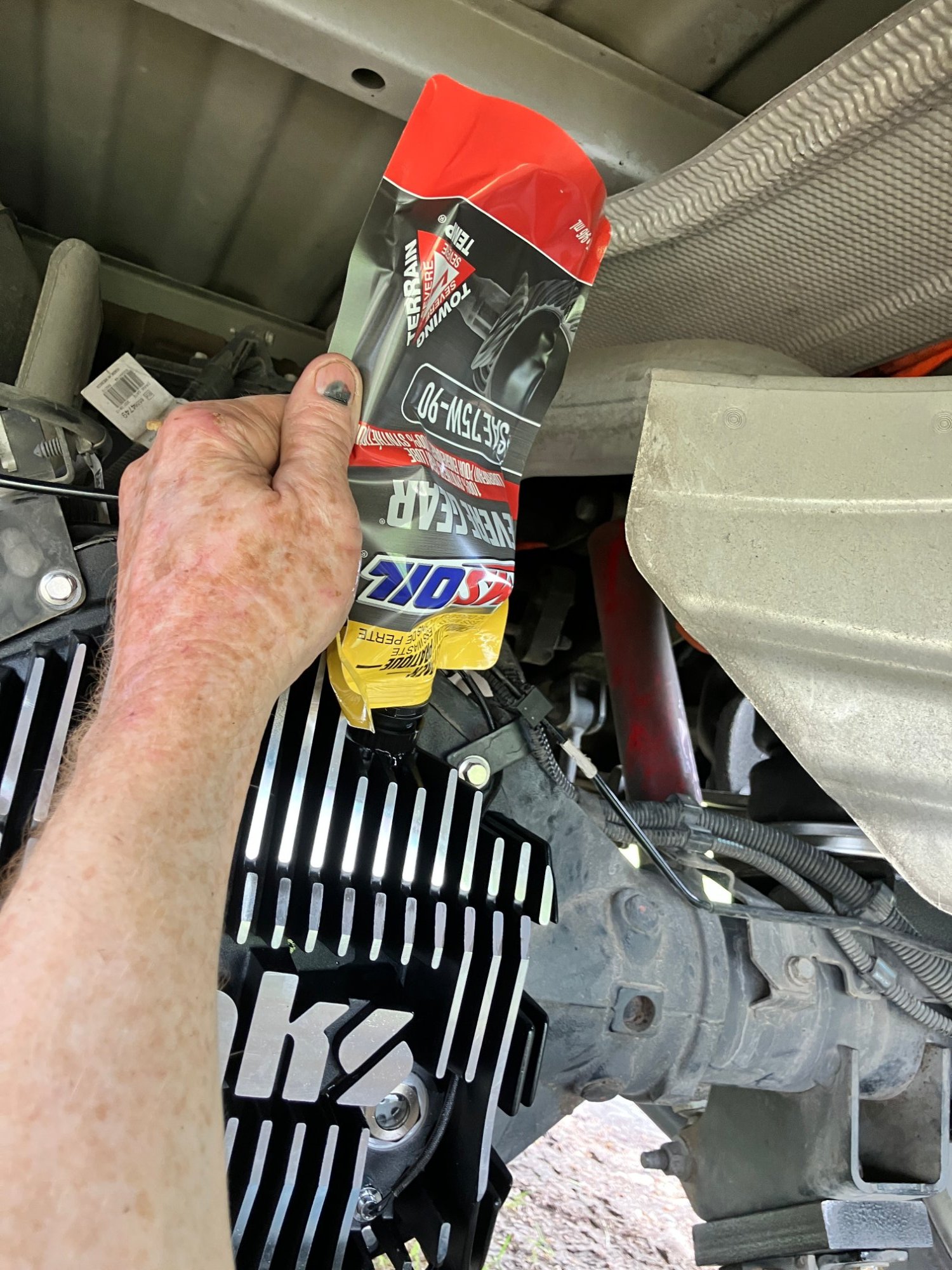

  12. Thinking on things over the week, I decided to use the remaining oil in the pouch. Basically, there's a gallon in the differential, minus a tiny bit of spillage and whatever remained in the bags. I think Banks designed this cover biased towards the standard Ram fill (some of those applications are greater than others, but by Amsoil's website, capacity is minimum about a pint greater than GM applications. In the picture, the differential appears fairly tilted, but it is really slightly tilted; the camera angle is skewed. With ~8 pints, the level is midway on the sight glass; you can see the center hole of the baffle to more closely judge the level. Regardless the 6.3 pint fill spec, I'm going to leave it as-is. I don't blame Banks for erring on the conservative side, and I don't know why there's such a difference in specs between GM and Ram. And I'd also speculate the cover volume is pretty much the same as the stamped steel, as @Chuck FB noted relative volume with his recollection of another member's fill experience.

  14. I agree it's ambiguous, and somewhat complicated with a shared application. For S&Gs, I just looked on Amsoil's website for a 2023 Ram 2500 with 6.4 gas. https://www.amsoil.com/lookup/auto-and-light-truck/2023/ram/2500-pickup/6-4l-8-cyl-engine-code-j-esb-j/ There's a lot of listings for Ram rear differentials, and too early in the morning to dig into the variants. But there's a big difference in fluid volume called for between them and GM applications, assuming it's the same axle assembly. So, if GM differentials tend to be underfilled, what does everyone think about a 7 pint fill, as opposed to the 6.3 pints listed on Amsoil's website? It would somewhat conservatively split the difference between Ram and GM specs.
