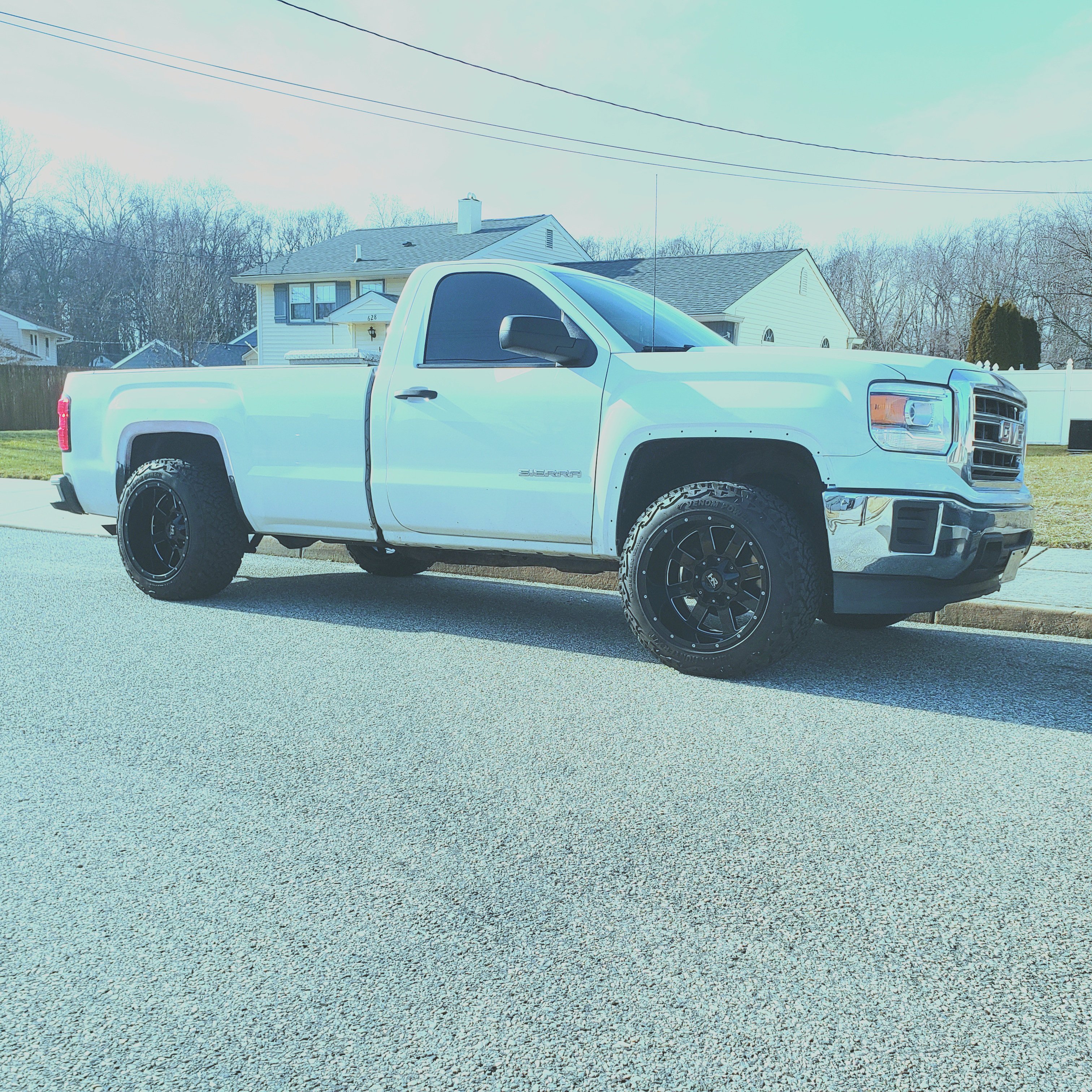

  1. @Snowcamo@steelerdude15Copy that. A few buddies said the same about the ground. I will try myself to find a bad connection, If I can't find anything I will have someone look at it. Unfortunately not very mechanically inclined. Will definitely post up any news. Its a 2015 1500 5.3. @64BAwagon I figured I'd have to go that route. I just wanted to reach out on here and see if anyone else might have had this same issue so maybe I could try and fix myself or atleaat give a mechanic a starting point. Appreciate the reply guys.
  2. Cluster will work (1/10 times from start up) for about 15 minutes until all gauges drop and other indicator lights come on. Truck was working fine with no issues until a few weeks after my local dealer replaced the fuse junction box. (Check engine light was not showing up when I turned the key so would not pass inspection). Recently had a local shop try and fix it with a used ebay cluster I bought but that cluster didn't work either. After I picked up my truck, the cluster worked fine for 2 weeks no issues then back to acting up like before. Is there something that is shorting or coming loose that I should check? Today leaving work, cluster was working until I hit my high beams and without skipping a beat, gauges dropped. PHOTOS: truck is being driven. Thank you in advance.
