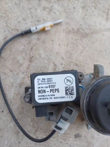

  5. FYI This is the only info I can find its a photo of a replacement ignition unit from a 2017 1500 Silverado. The ignition cylinder lock actuator cable has been know to cause problems GM has a recall on some 2014 and 2015 Silverado models due to this problem. Tomorrow I will check this on my truck if the cable is sticky or stuck before i jump the gun and spend a chunk of money on either a new key cut or and entire ignition , as this issue only happened after a sever cold snap with no prior issues at all.
