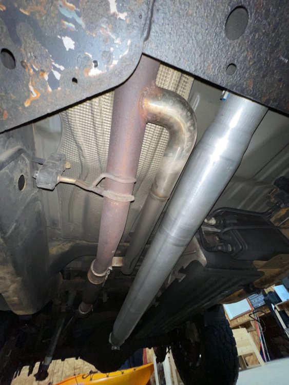

  2. It looks like they used magnaflows 50 state compliant system. When the light first came on for me I replaced all o2 sensors with acdelco's
  3. No aftermarket headers, in November I had a Jasper reman. engine put in, it's a afm delete model, meaning it's just a simple pushrod gen 5 Lt 5.3 with absolutely no afm bullshit. Factory headers, muffler is a magnaflow magnapack. Also no crazy tune. Jasper flashes their own just to make sure the computer doesn't try to put it in v4 mode.
  4. No aftermarket headers, in November I had a Jasper reman. engine put in, it's a afm delete model, meaning it's just a simple pushrod gen 5 Lt 5.3 with absolutely no afm bullshit. Factory headers, muffler is a magnaflow magnapack.
  5. That's what the tech described it as, I've never heard of such a thing
