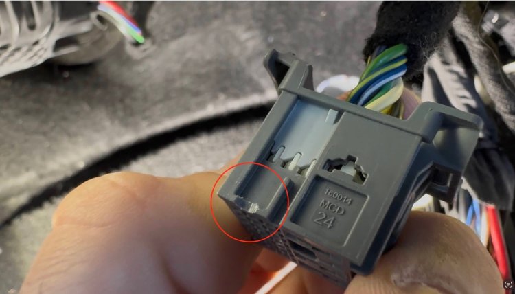

  3. sorry I never got a notification for this reply. Did you get it figured out or still need help? The resistors go between + & - on the front left and front right speaker wires. One of the pics in my post above shows a red circle around where I had to cut the gray ACM connector to make it work. The resistors are required to make the chimes and blinker sounds work.

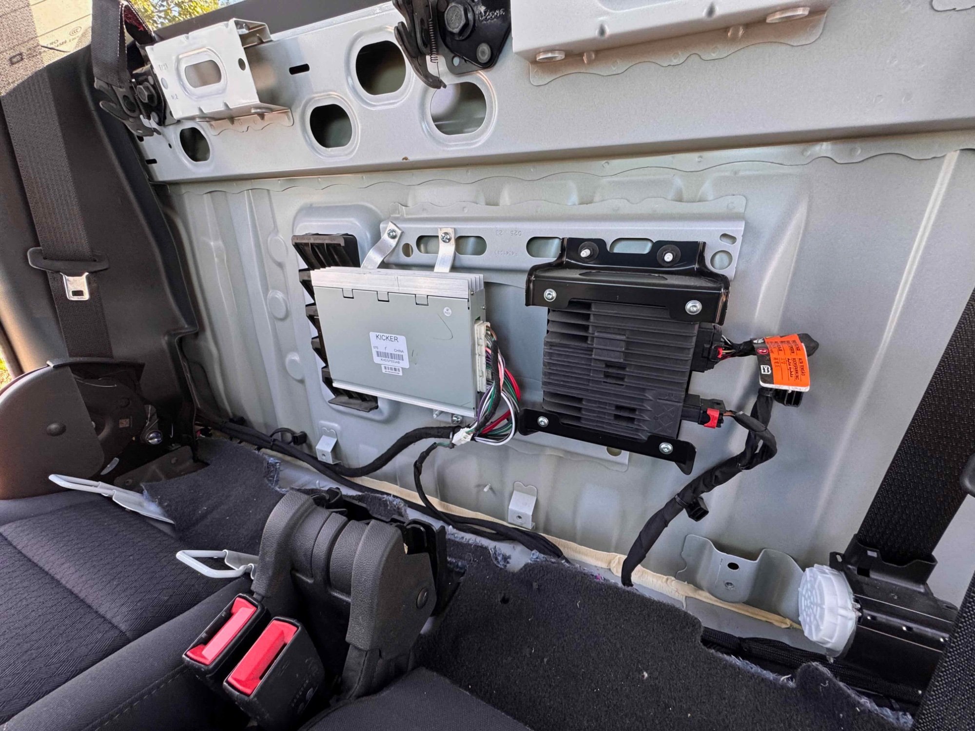

  7. Posting as general info. I bought the GM Kicker 200W DSP amp and 200W sub (#19417166) for my 2023 LT and it works. I had to very slightly modify both the gray ACM connectors which involved cutting a small amount of plastic to make a groove line up to allow it to plug in (see pic). The DSP amp is listed as only being compatible with 2019-2021 IOS radios. I have the 13.4" IOK non-bose. I did have to add load resistors on the front speaker outputs to retain blinker and chime tones. I bought the sub new, but I found the DSP amp on eBay for $200 and figured it was worth a shot after seeing the pinouts are the same between IOS and IOK. The seller had removed the bracket so I fabricated one with aluminum flat bar.
