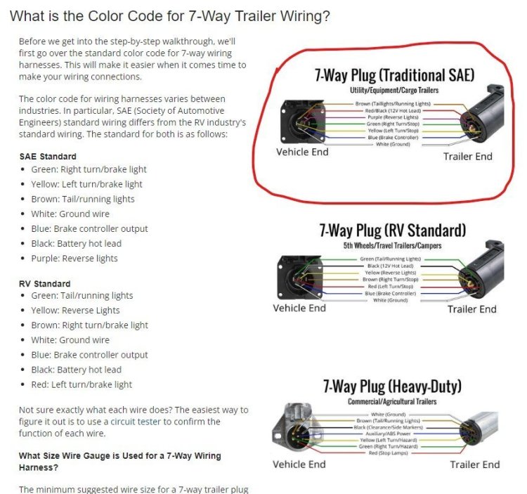

  8. I have owned 2 gooseneck trailers, a race car trailer, 30' tongue pull travel trailer, 42' 5th travel trailer 24' car hauler, and 3 16' utility trailers. The travel trailers pigtail have always been an issue until they are clocked correctly. I was more talking of the clocking of the wires to work correctly. To me makes no difference about the color. I have no idea why some RV or other trailer group came out with the RV pin out. Why can't everything just be the standard 7-way. I have come across this with the last 5th wheel I pulled and rewired the trailer plug to match my trucks. My F-350, 2500HD and my new GMC 1500. I have learned over the years to verify the trailer is done correctly from 4-way, 5-way and 7-way. Hate the 5-way cause it seems to be a bastard for any trailer plug.
  9. Sorry, I am not incorrect. I just checked my 2024 and on the cover of the 7way connector it shows the 7way (Traditional SAE wiring. Plus I just completed rewire a trailer that I haul with and added the reverse lights. Here is the picture of different 7way setup and my 2024 is the traditional pin out. My 2013 2500HD is the same way as well and had an issues the first time I hooked it to my 5th wheel travel trailer.
  10. Your truck is wired for normal 7way and not RV trailer the pinout is different. Do your research on trailer wiring diagrams.
