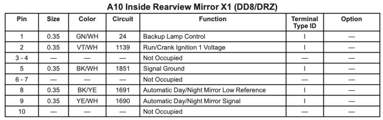

  4. Is Pin 10 B+ then?

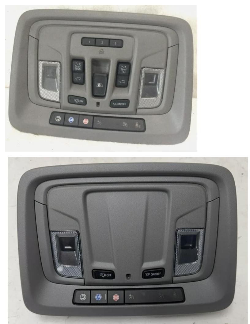

  9. Thanks to @Semedar for his post in August of 2019 for HOW to FREE the power connector to make most of this possible. I found maybe the most effective way for me to RELEASE the connector was using rubbing alcohol on a brush (Like @bonzman17 said) I came here to install a Dash cam that uses the AutoDim power connector for power. Once I found the power connected and freed it, that was simple. NOW I want to ADD the AutoDim rearview, and remove my visor mounted Garage Door clicker and IDEALLY have those functions moved into a HOMELINK module mounted in my Overhead Console. It seems that there are only 2 (that I have been able to find) options for Overhead Consoles in the 2019 + trucks, WITHOUT HOMELINK, or WITH HOMELINK and with Sun/Moon Roof controls. Has anyone added HOMELINK to their 2019+ Truck? How did you do it? Where you able to find an OEM Overhead Console with the HOMELINK Module and Buttons?
