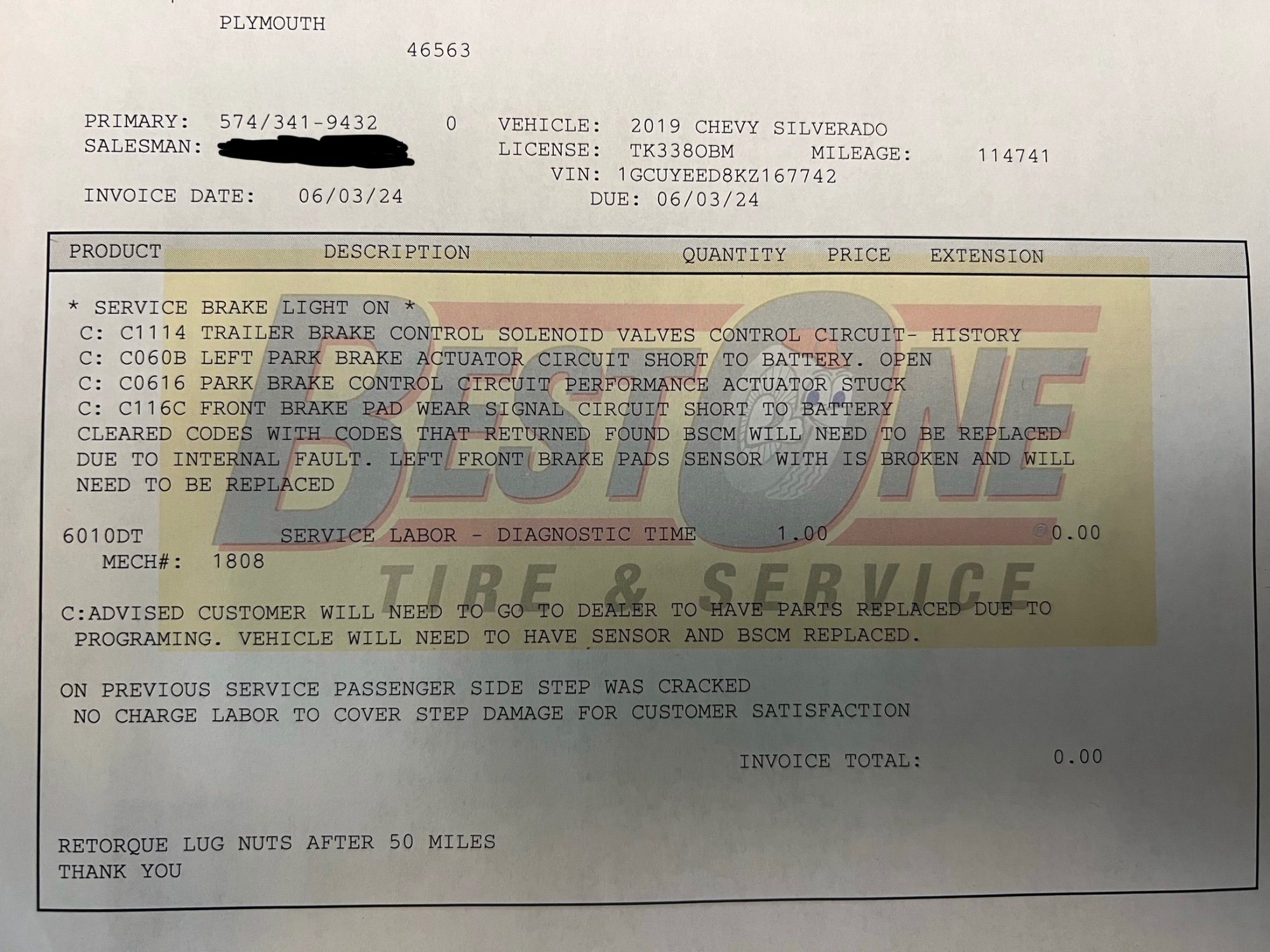

  5. Do you know if this is something I can do at home?? Could you send a copy of the invoice to show part numbers?? If I can avoid a huge expense…it would help greatly!
  6. Have had my “Service parking brake” light and warning message on for a little bit now. Read about software update as a possible fix. Took it to a certified dealer and had them install the update and paid $150+ for this. Did not fix issue. Took it in today for diag at my local shop…pictures of invoice to show diag. Has anyone found the formal solution to this?? Getting really frustrated with this whole ordeal. This is my first truck purchase…I have always loved Chevy/GM…just not loving this situation right now. My personal scanner first detected a P25A2 code from the OBD2 connection. Still no resolution and money spent going in circles…GM Customer Service…can you please help me??!!
