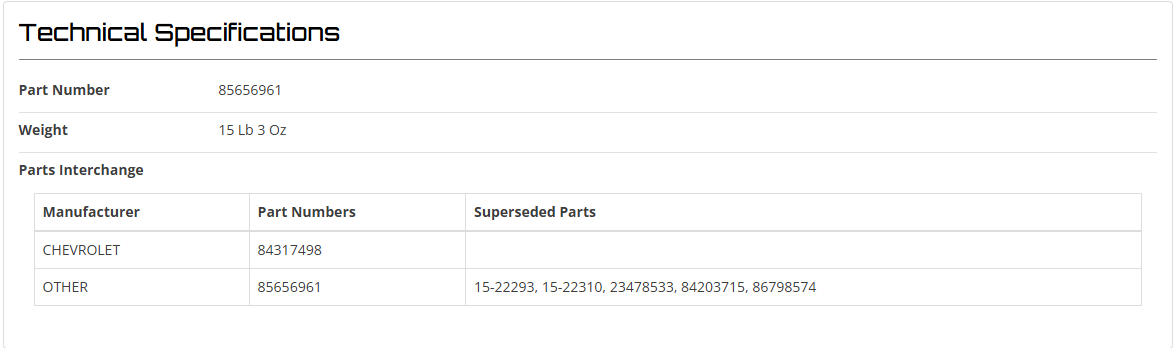

  6. Can someone please tell me if both these GM A/C Compressors are the same or is there something different about them? My vehicle calls for GM Part # 85656961 but when I enter that particular part number on Rock Auto it brings up 2 separate GM compressors with different part numbers. On another website I found the information in the 2nd photo that shows GM Part # 85656961 superseded #86798574, #84203715, #23478533, #15-22310 & #15-22293 which makes me believe they are both the same. Thanks in advance for the help 2015 GMC Sierra 1500 Denali 5.3 Flex

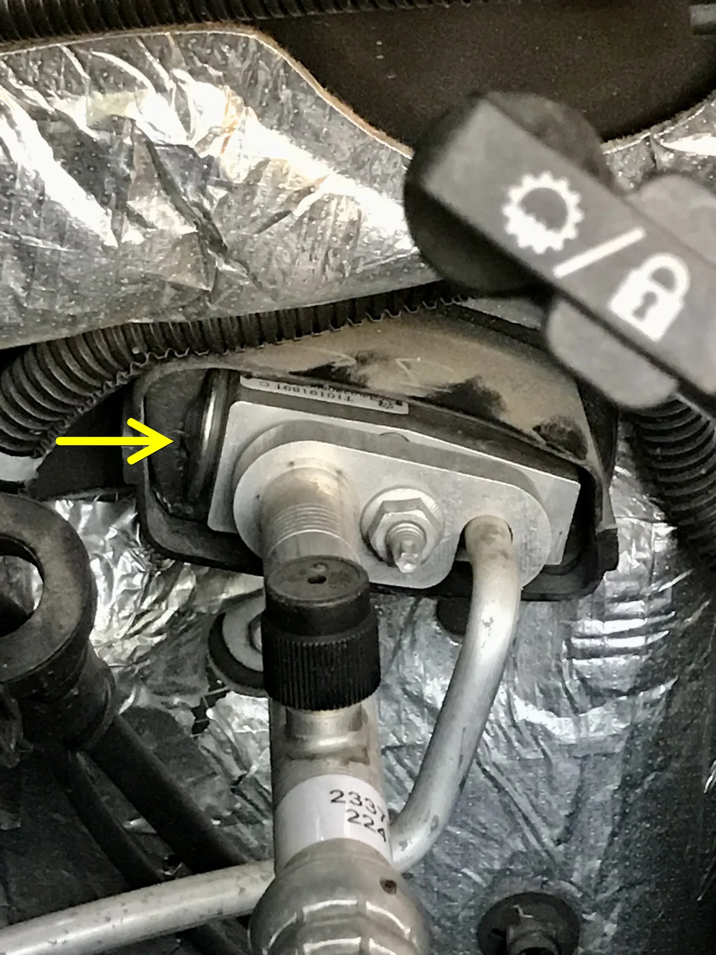

  7. The bubbles are present if I spray soapy water around the expansion valve then turn on the AC on. The bubbles are also present if I spray soapy water around the expansion valve and just turn the fan on by itself. The minute I turn the AC & Fan both off the bubbles stop. Maybe I'm wrong but I would think there should be bubbles all the time if the expansion valve is actually leaking. Thank you for offering to help us.
  8. I followed your advice which I appreciate but now I have another question. As you can see in the photo below when we sprayed the soapy water on the expansion valve bubbles appear. If I turn off the AC off but leave the fan running bubbles appear. If I turn my fan & AC completely off the bubbles stop which I don't understand. The AC system in our truck is currently charged and working properly. Why would the bubbles stop the minute I cut the fan off if the expansion valve is leaking especially in a pressurized system? Is there any chance the air coming off the evaporator blower is passing by the expansion valve causing these bubbles? I guess if I put UV Dye in it would answer my question but I thought I would throw this out there. With the amount of bubbles I was seeing I wouldn't think a system would hold freon more then a day where this one is lasting about 2 weeks. Once again thanks for the help
  9. My Dad owns a 2015 GMC Sierra 1500 Denali with the 5.3 engine package. A few back he noticed the truck wasn't cooling like it should and after checking the low & high side pressures decided to add a small amount of freon. When I say small I mean small because all it took to get the truck acting right again was about 5-6 oz of freon. Fast forward 2 weeks and now he is back in the same boat again and has began the process of tracking down the leak. The first place I looked was the AC Condenser but luckily his hasn't broke at the top corner like many others have experienced. Today I had my HVAC freon checker/sniffer out going over the truck and every time I passed over the left side of expansion valve it went off. Does anyone know if these Expansion Valves are known to leak here? The freon checker didn't go off when I passed over the o-rings where the cooling lines connect, it would only go off when I passed over the left side. Thanks in advance for any help you can give.
