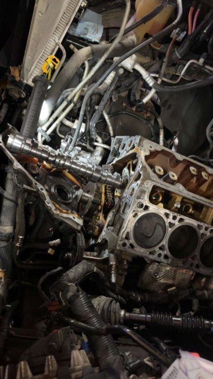

Recently did the AFM/DOD delete and cam swap (BTR Stage 2) on my 14 sierra with the 5.3. This was a couple months after having my trans rebuilt. Everything seemed fine before the cam swap and after the trans rebuild. Or at least thought it did.

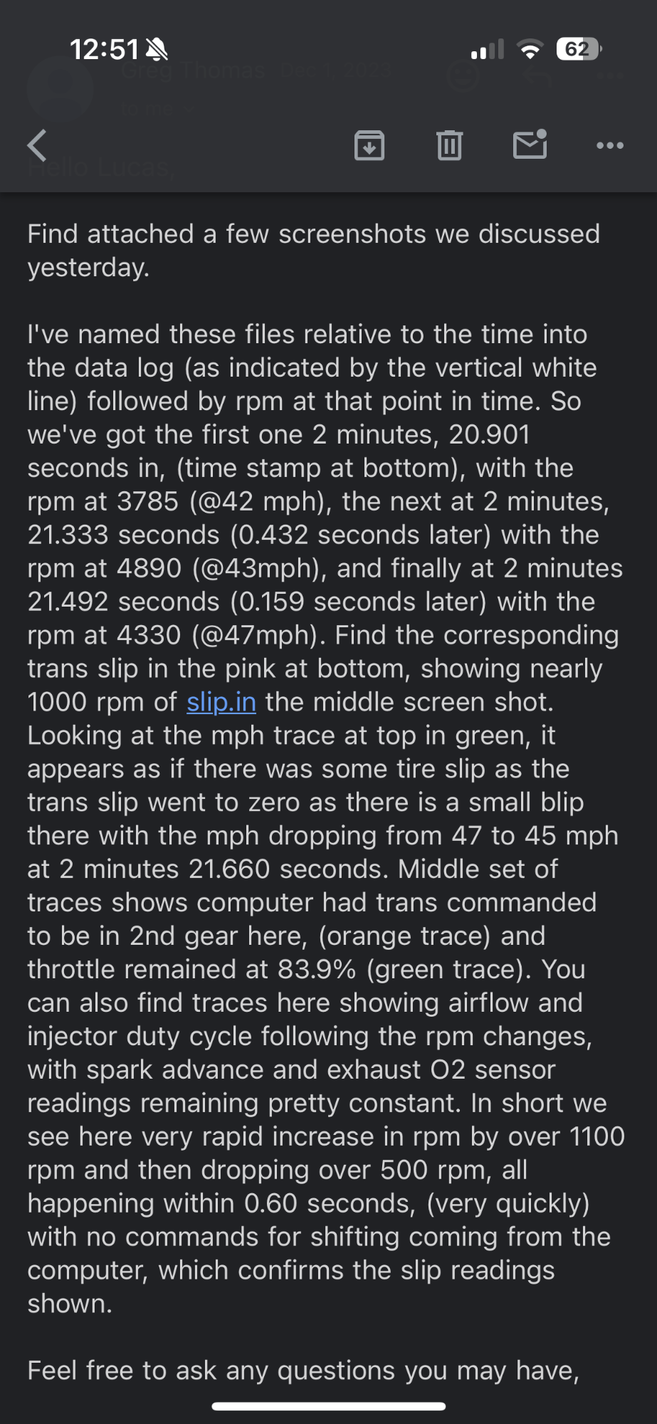

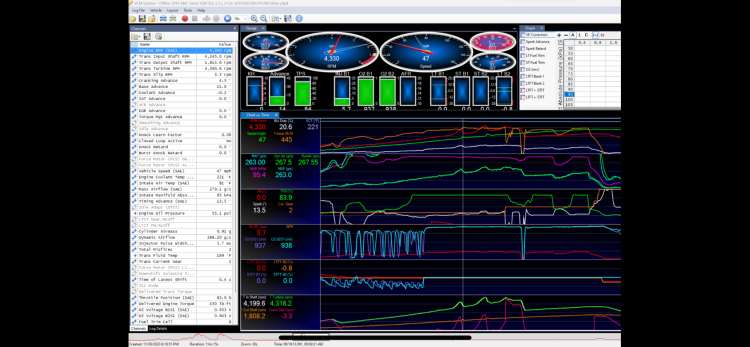

After many hours with tuner saying that truck had idle problems, problems dying after starting then shut off then trying to start back. And problems shifting when hitting the throttle. My tuner says my trans is slipping upwards of 1000rpm in a 1/10 of a second. As well as some spark delay.

I also believe the cam just doesn’t chop as much as it should in other videos I’ve seen. I’m stuck and not sure what to do. Plz help!
