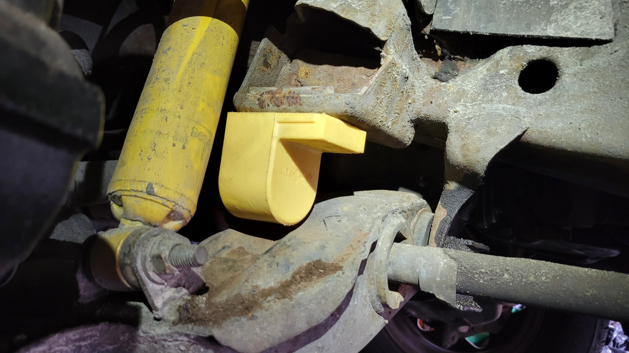

Thanks, again, for pointing out the missing rubber bumper and helping to clarify where it was supposed to be! I was able to find replacement parts at Napa (I was surprised that they are about the size of your fist). It was difficult to get the nut off the old, rusty bolt, because the OE bumper was COMPLETELY disintegrated, but I eventually prevailed. I put it to the test on a drive on a Forest Service road with big dips in the road and no problems with bottoming out the front suspension anymore. Here's a picture of the front suspension with the new rubber bumper installed. Cheers!

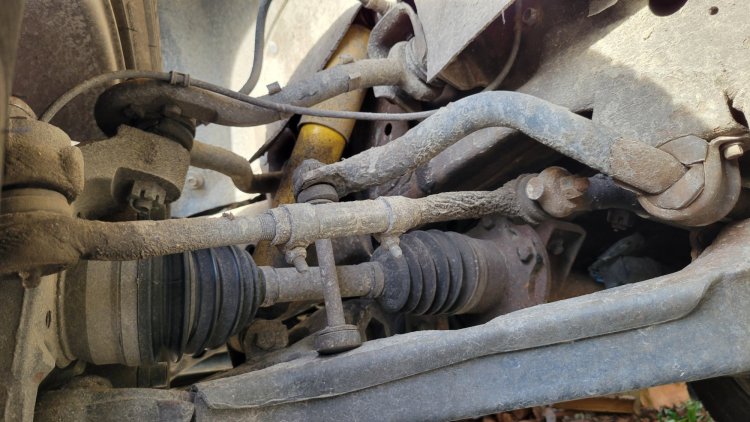

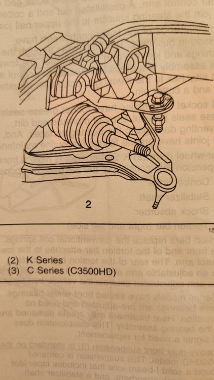

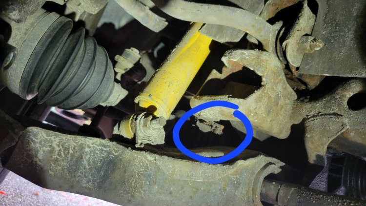

Thanks for calling my attention to the jounce bumper! I have the FSM, but I haven't been able to locate the bumper to make sure I'm looking at the right part. As far as I know, the bumper is original (I've owned it for over 20 years). Here's a drawing from the service manual, as well as a picture of the front suspension in my rig. Can you point out the jounce bumper? TIA!
