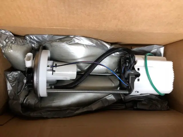

  2. Hi! So about 2 months ago my fuel pump went out. Had it replaced and right away we noticed sometimes it would crank but No start. After a few days the pump was defective, so replaced it again. Pump ran great with good pressure but after about a week or so, same issue crank but no start. Sprayed some starter in the manifold sometimes start, sometimes no. Turn key on/off to cycle and then sometimes start, sometimes no. Used the pressure valve behind the spider to bleed air/fuel then engine start fine. Would run fine for a couple days up to a week and then same thing all over again. Took it to local chevy. Diagnosed fuel pump, ... good to go they said, everything working properly. 2 days later No start and this time cannot get it to turn over, pressure is at zero. Pump is still turning on but not humming like it was. Replaced MAF and distributor cap as well as fuel filter. My local mechanic and I are stumped, and I'm already $1000 in on repairs. Please help!
