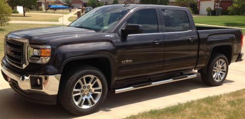

There's a total of 3 on each side. I took a pic but u can only see 2 from the angle I took it from. See the silver washer u need to tighten those bolts with a torqu wrench 70ft lbs

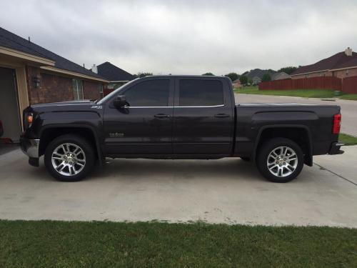

After u said that I tired it today. I took off my side steps and retorqued the body mounts bolts to 70ft lbs. Vibration in the seat and console is gone so far that I know will drive a week to verify. Had the 70mph and above vibration and 40-50. But also the dealerships put 4new tires and rear shocks.

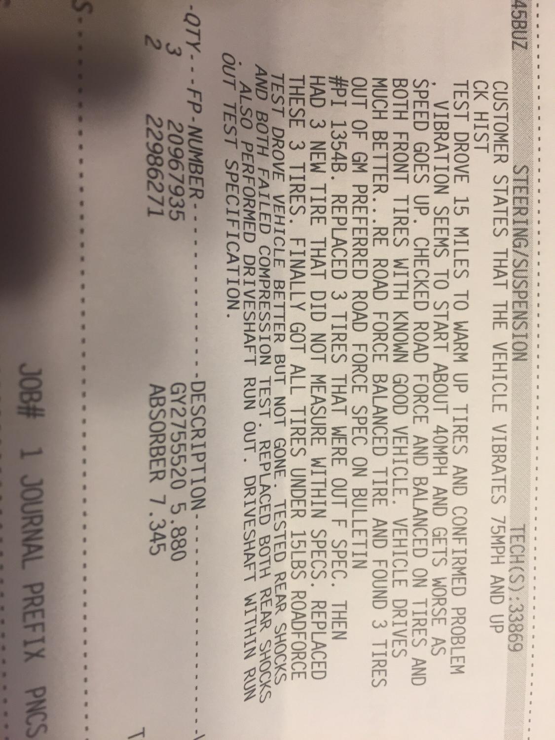

Truck goes back in tomorrow for road force which doesn't make sense. Service manager giving us the run around. Saying they can only road force balance again and nothing else they can do. And suggested we call the dealership we bought it from. Asked about gm tech to come in and check it out and try to give us a hard time about that also. So he finally agreed if the rf doesn't fix he he will try to get a tech in. Just in case anyone missed it attached is the write up from gm
70ft lbs I have the body mount steps. Never changed anything by putting them on and checking them
Got my truck back today. 3 brand new tires, 2 rear shocks, driveshaft is within tolerance. ZERO Change. Time to call them again in the morning. Attached pic for the write up from gym
There stock shocks. He told me gm said when they replace the tire they replace the shocks as a precaution. There hoping this fixes it which I doubt it. will find out tomorrow hopefully when the shipment comes in with the shocks.. I still think it's driveshaft or rearend related.
