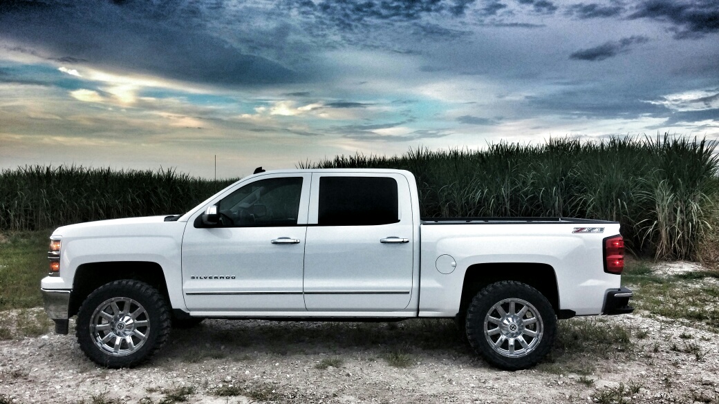

  2. 2014 ltz z71 summit white rough country2.5 level 33x12.5x20 federals 20" AX805 Force rims

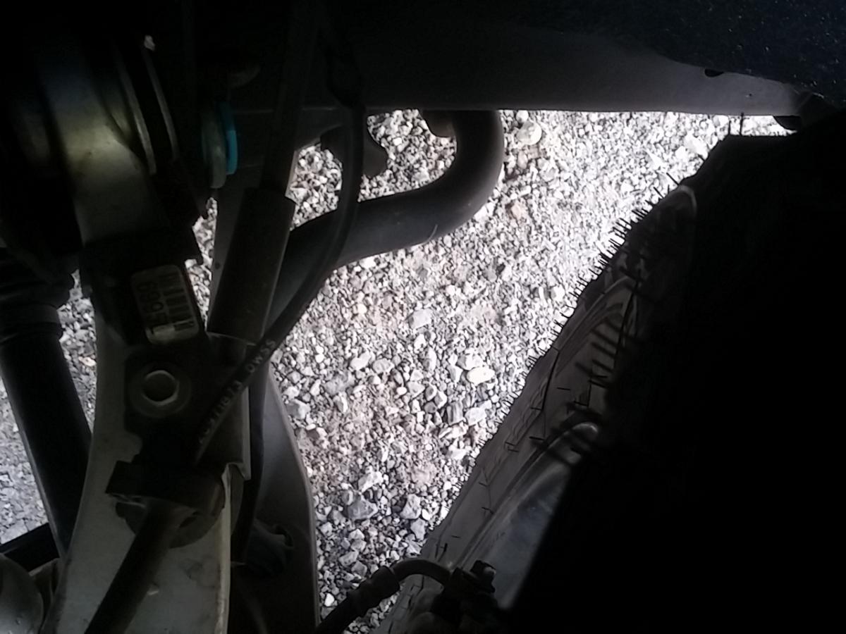

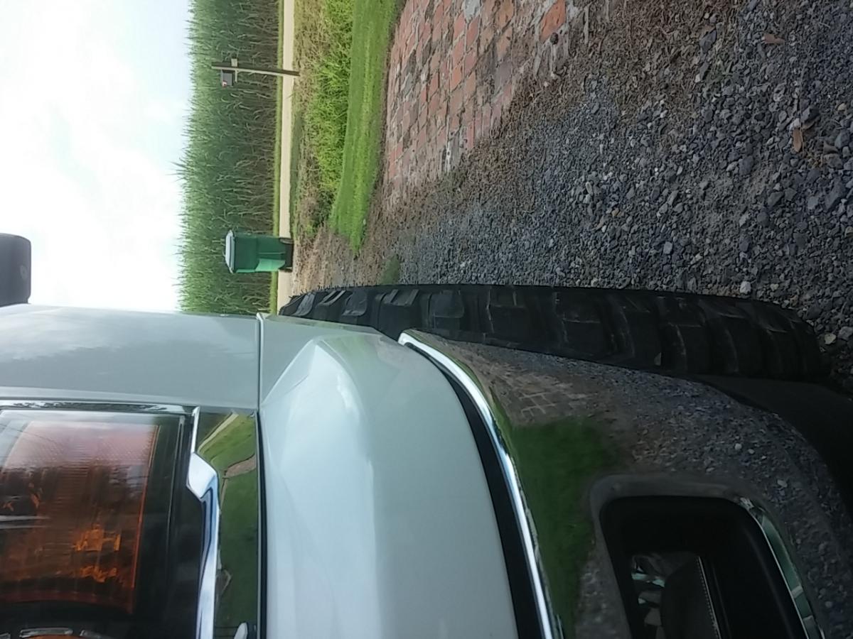

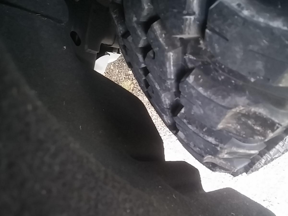

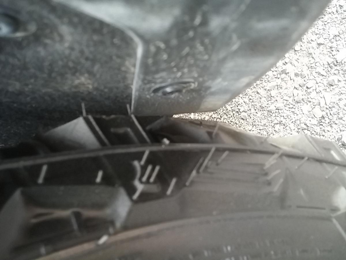

  3. quite possibly because I can barely fit a finger between back of fender and tire on front

  6. no trimming it only rubbed once been trying to do it again just backing into parking spaces so I can get out and see whats rubbing. but it hasn't done it again, will try it out this weekend and try to take pictures of clearances
  7. 2.5 RC Front only 33*12.5*20 Federal Couragia ATX Force AX805 -12 offset Only slight rub in reverse at full lock front is 1/2in lower than rear
  8. my 2014 Silverado Z71 LTZ 2.5 level in front 33*12.5*20 federal couragia MT 20" atx ax805 force wheels -12 offset
