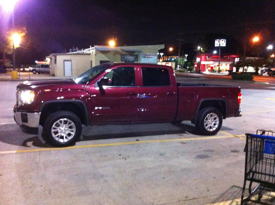

  2. I installed my 2.5" level myself. Mine sits about 1" higher in the rear with the 2" block in the rear. If you want it to be "dead level" take the 2" block off of the back.

  5. The first two are with the stock 1" block The second two are with the RC 2" block Originally I installed the front and drove the truck like that for about 5 months. It made it dead level. However, even though measurement wise it was dead level it looked like the front was a little higher than the rear. So, I installed the rear 2" blocks and that made the rear right at 1" higher than the front. I personally think it looks best with the 2" block but it is all personal preference. With the stock 1" block at some angles it looked leveled and at others it looked higher in the front and I do not like the "higher in the front" look. So, if I were you I would install the front, ride with it like that for a little while and see how you like it. Then, if you don't like it or if you just want to change it up, put the rear 2" blocks on. I also think once I put bigger tires on it the little bit of rake I have won't be as noticable. Good luck with the lift! Post pics after and holler if you have any questions.

  8. Truck looks great. I have the same set up SLE with the same rims. What lift do you have on it and what size tires (2XX/XX/XX)?
  9. Mine was the exact same measurement as yours before I installed the 2.5 RC kit. I DID NOT put on the rear block and my measurements after the lift was installed is 39.2 in the front and 39.5 in the rear. I personally love the way it looks. I've been riding with the stock tires now for about 5,000 miles and am getting about 18mph average. I also took off the front air dam, so that may have affected my gas mileage as well.
  10. Nothing special. Just got it washed. Can't wait to put tires on it.
