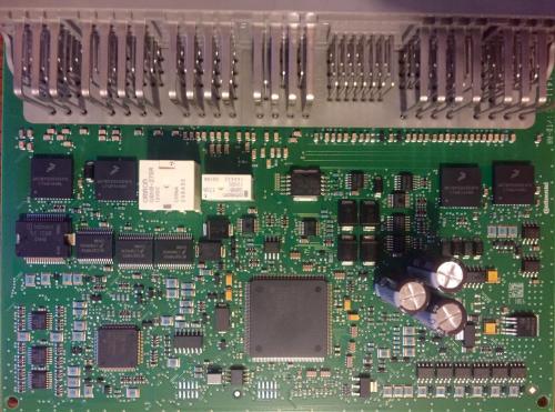

I took the truck in today and got it diagnosed. The diode mod, performed exactly like the steps in this forum, somehow shorted out my BCM. I can't believe that would have done it, considering several other things that BCM controls work without issue. Well, new BCM and programming repair will cost one $675 dollars, all because I forgot to take out the damn diode before going to the dealership. Hard life lessons. sidenote: I also performed the footwell lights modification and I'm certain this somehow factored into the equation. I just removed the bcm and there are no chared areas or visible broken solders. If the bcm shorted out, wouldn't I be able to see something on the circuit board? Can any trained eyes spot any areas of interest where I can snap a closer photo to post. With everyone who has had zero issues with the diode mod, I find it hard to believe this is the case. I think they saw the mod and blamed it all on that right away. You think my fog light mod truely causes my issue? Other side
