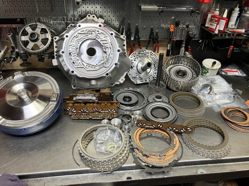

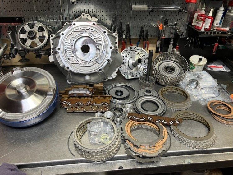

  5. My trans shop texted pix of new parts and said he's about to start the build on my trans. Billet converter and many upgrade parts for the common problems. He knows I tow my jeep, so he's using his experience to ensure it's upgraded in the right places.

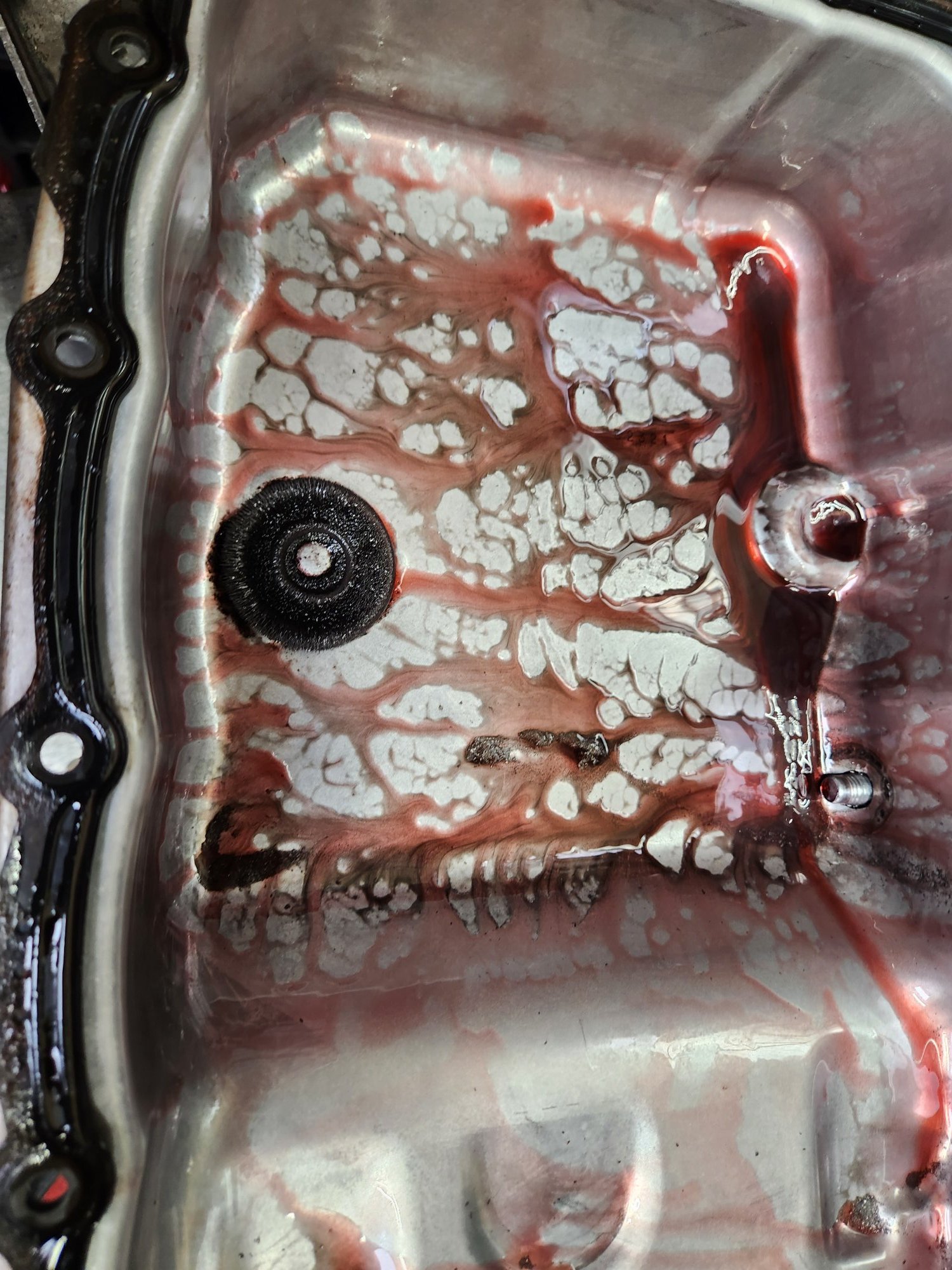

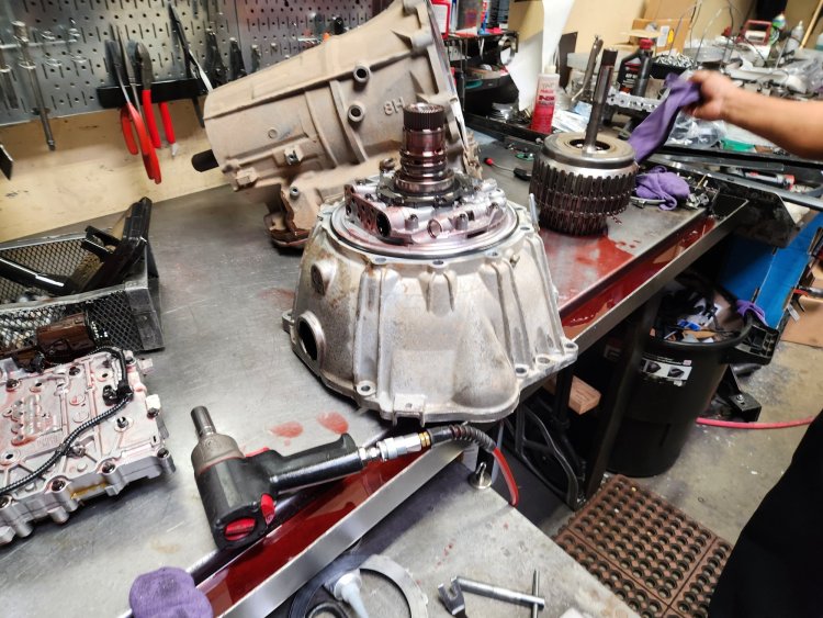

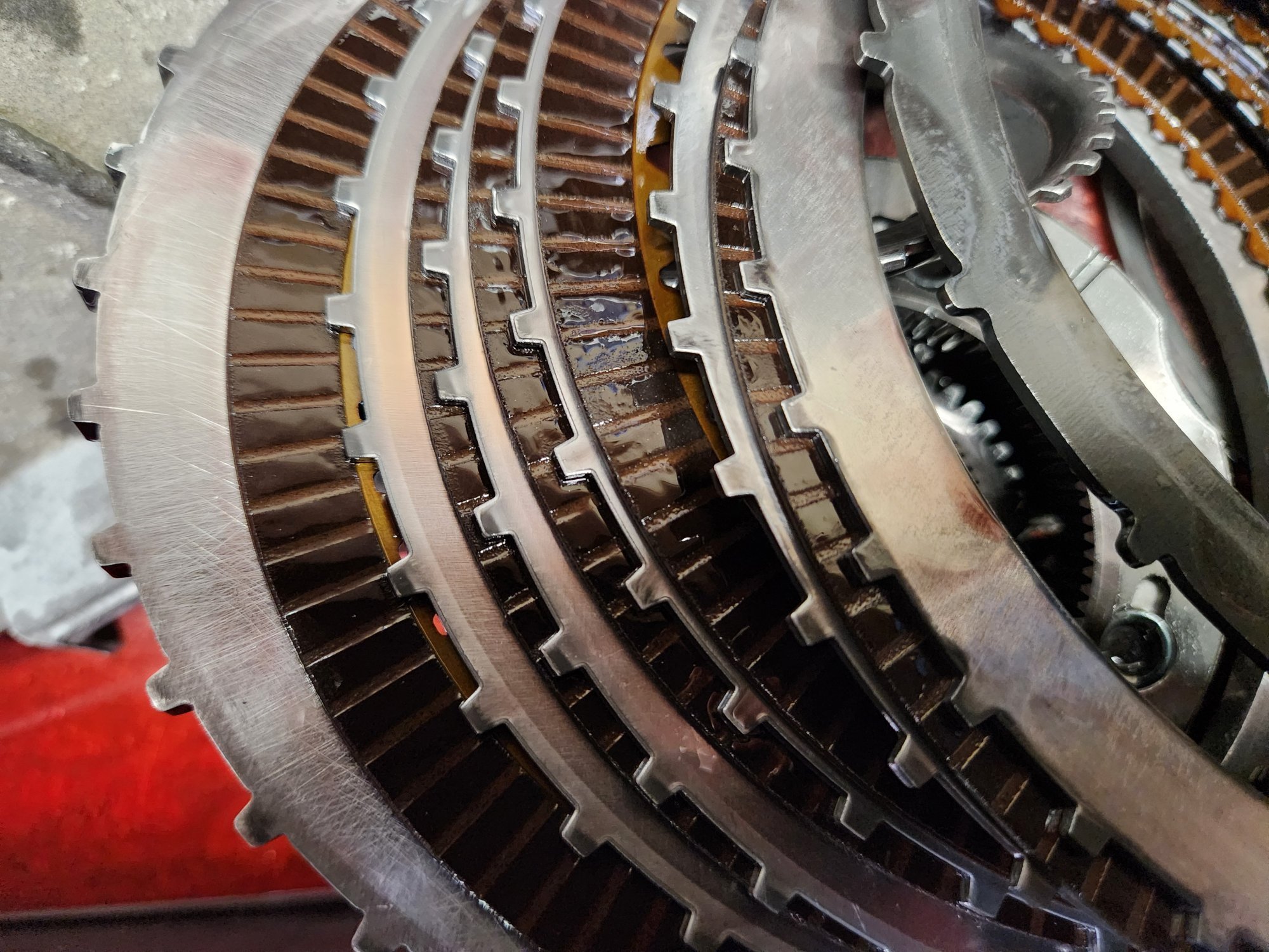

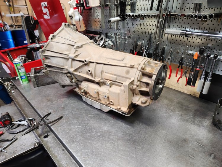

  6. Although I haven't got my truck back and running yet, I'm going to say this shop and the manager Art is trustworthy and knowledgeable. I think I did well to have unhooked my jeep and drive separately up to the Rubicon and back. Looks like the converter was shedding metal pretty fast. I didn't shoot any pix of the fluid I dumped just 20-30 miles before taking it into this shop, but it was gray metallic. So, the metal in the pictures isn't as dramatic as it may have been if I hadn't just changed the fluid right before the teardown. The second picture of the donut magnet is an indication. I found my sticker on the pan today, which said I changed the fluid in June 2022 at 95k miles. It made it to 114k miles. Here's some pix of the teardown. It really isn't terrible. Some wear in the pump, but the clutch packs look pretty good. The one picture of the solenoid screen with metal, would likely have burned the 4,5,6 clutch pack, per Art. Art said he'd have it back together by Tuesday-Wednesday.
  7. I think I found a good shop. The truck has been there since Monday. I spoke with the guy at length about these transmissions. We talked about billet converters. He uses them. We talked clutches, fluids, coolers, got the shop tour, transmissions in build, etc, and I'm convinced this guy knows these transmissions and is honest as the day is long. I told him my use of the truck for towing the jeep. He will do the build himself rather than a big box replacement. I gotta start letting go and having shops do more repair and maintenance work on my vehicles. I'm just too old to do this kind of work any more. I think I've found my transmission guy. Kako Transmissions in Gardena, CA I dropped it off Monday. The trans is out and I'm invited for the teardown this morning. I'm just hoping we don't find so much damage that the parts costs start going up.

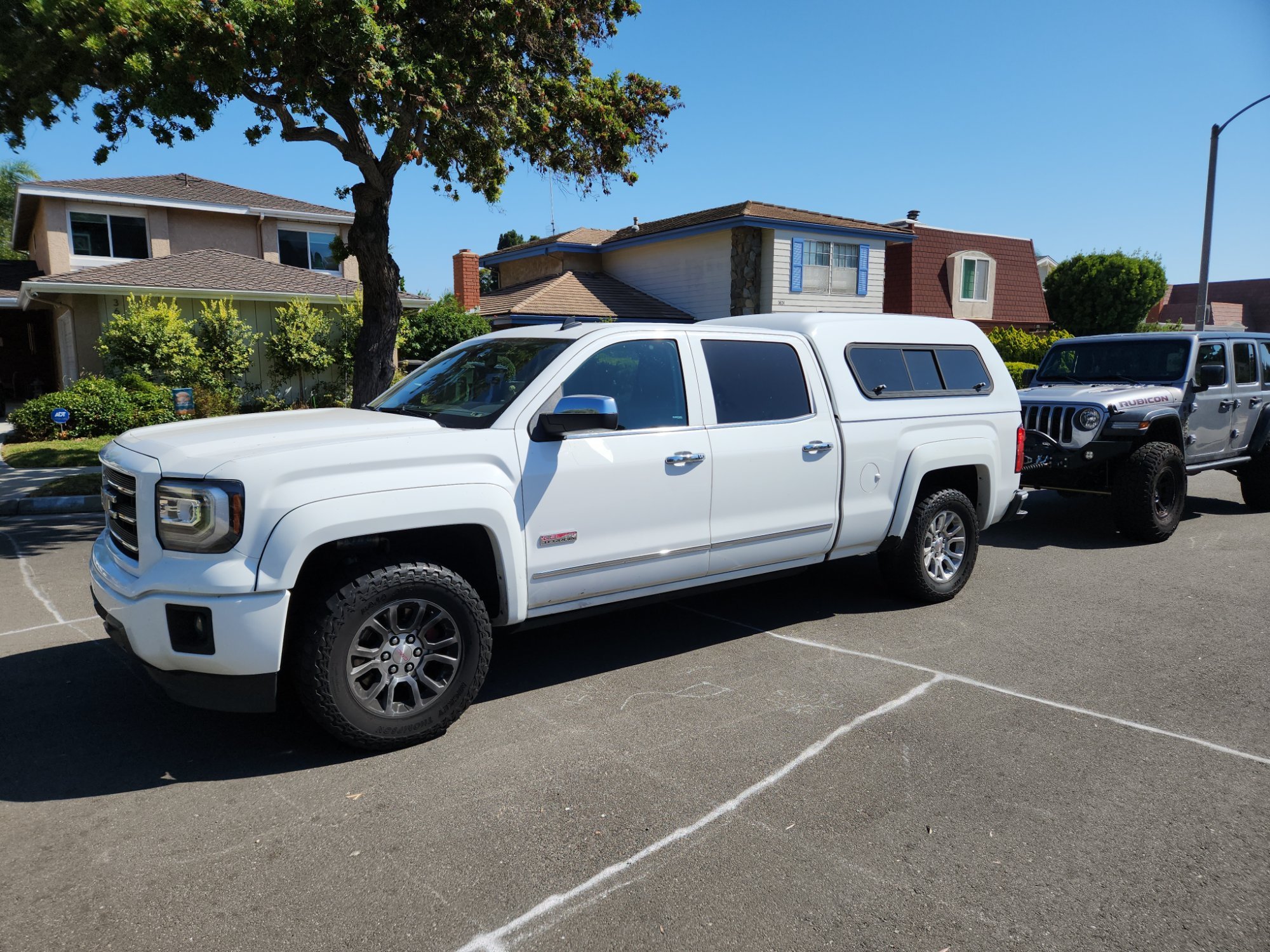

  15. 2014 1500 CC LTZ 5.3L (6L70/6L80?) 4WD. I was towing my jeep up to the Rubicon trail Sunday, when I noticed the driveline would vibrate/shudder under light acceleration while cruising on the freeway. Never heard this before. We pulled over and checked the rear driveshaft and it all looked and felt good. No grease or debris around the U-joint trunions, etc. No looseness in the U-joints. We unhooked the jeep and drove it the rest of the trip, but we were still getting the vibration. Definitely torque related. Only vibrates/shudders under load. I have some ideas as to what it might be, but I trust the opinion of some of you more. @Grumpy Bear where are you?
