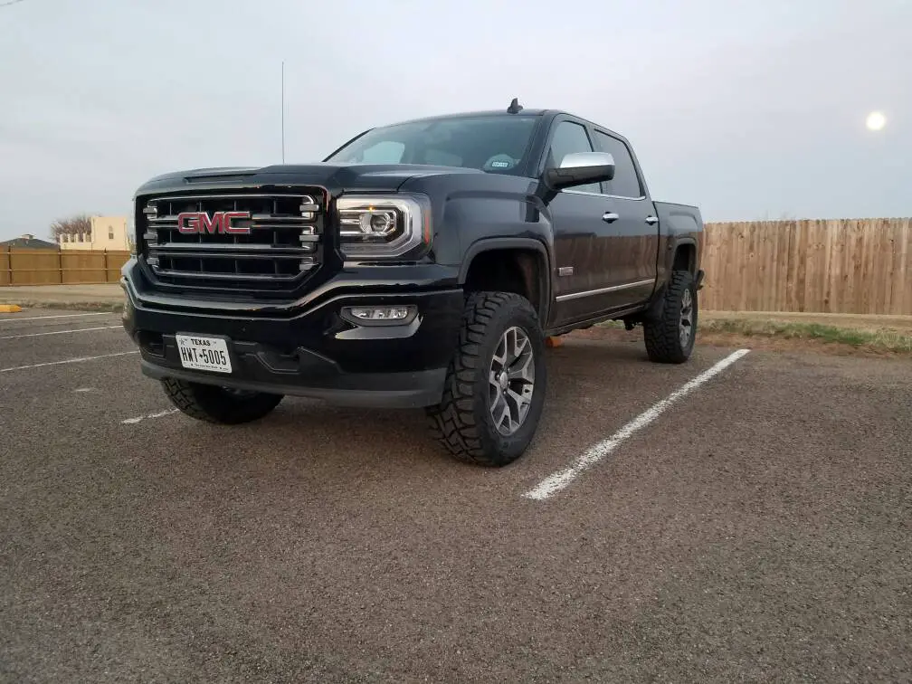

  13. don't have any on the work computer and just got a new phone. I posted some a few months ago in this thread about clearance in the fenders. this is the only one I could find for now. this was when I first got it done...its been about 12k miles and am very happy I did the 4" still planning on upgrading to the FOX shocks and coilovers.
