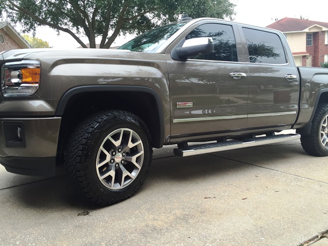

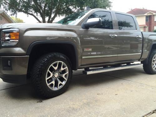

  16. I have the 5.3 w/ 2.5" RC level and rear stock block. I didn't get before and after measurements but my truck still has a 3/4"-1" rake and that's pretty much where I wanted it. The suspensions on the All Terrains area little different from others and you may not get the exact results as I did if your dealing with other than an AT. Here's the only pictures I have.
