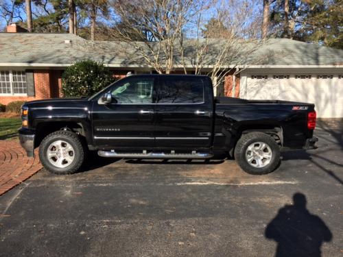

  6. The Fox coilover gives 2". Right when I installed it was about 2-1/2" but it settled over time. The picture looks a little nose high, but my driveway slopes up. It is dead level. It is the only adjustment I have made to the truck. May add some rear blocks as i do tow a trailer and a boat on occasion.
  7. Installed Fox 2.0 coilovers and BFG's this weekend.
