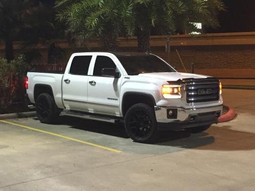

  1. I have 305/45R22 with a leveling kit on my 2014 Z71. The 22x9" wheels are the same width, same offset, etc. as the factory 20x9" other than the diameter of course. The tires only rub just a little on the inner fender 'carpet' at full right turn only. Not all factory GMC wheels have all the same specs. I believe the 22" CK164 wheels (and the 22" Cadillac Escalade wheels) are 8 1/2" wide but I don't know the offset. The width and offset will make a difference on if and where the tires might rub.
