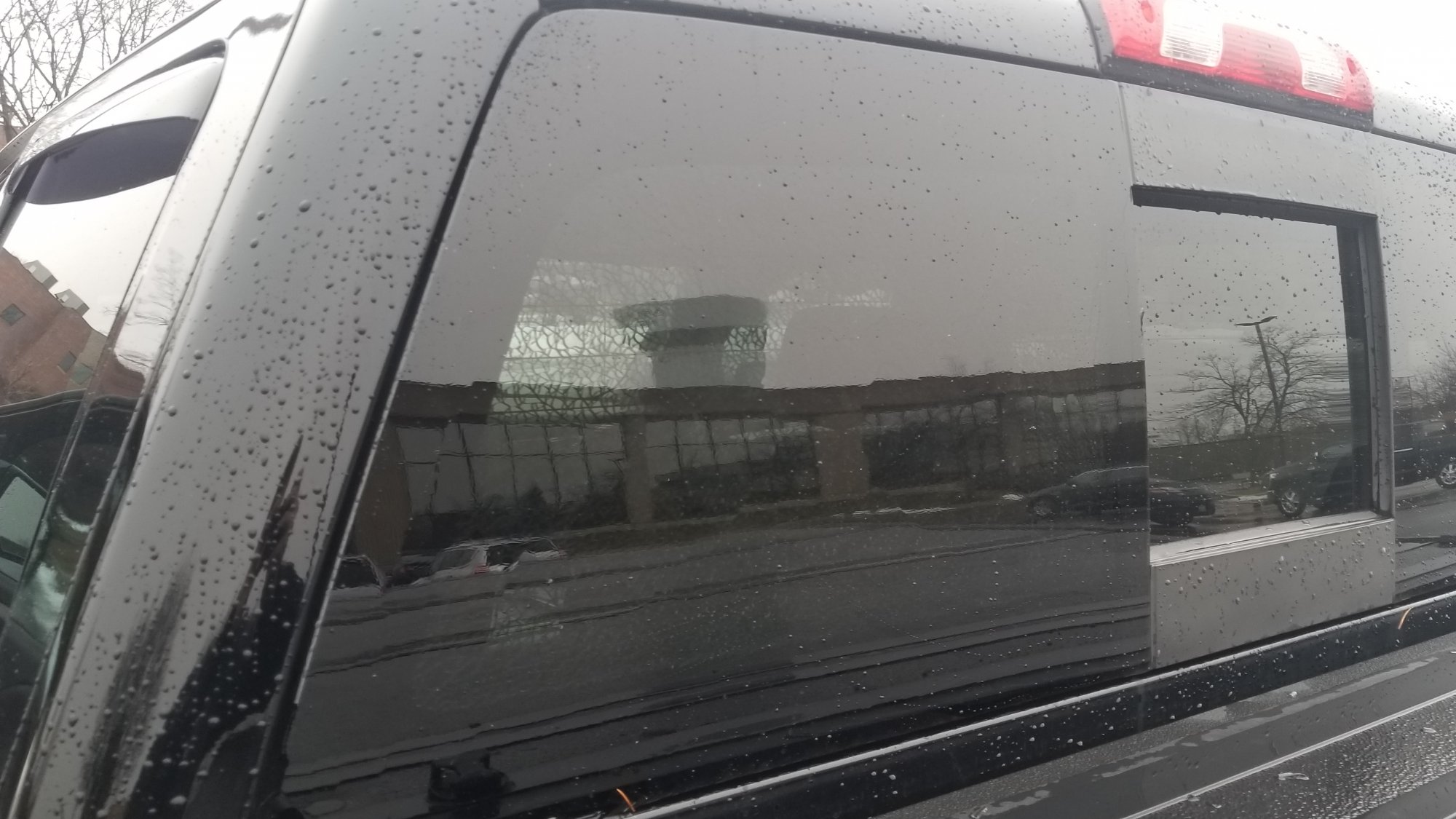

  1. It is $1050 to replace the whole 3 window assembly at safelite. FYI.
  2. I'm surprised to find out that the single glass piece cannot be replaced on the sliding glass models. It is a whole assembled unit being replaced on mine. Need to take the back seats out even to access the motor. Hopefully this will solve all my issues.
  3. I wanted to provide an update. The dealer was not willing to help me out after all and I went the insurance route with safelite. Hopefully installation goes good next week.
  4. Wow! Are you paying for that replacement? I thought most insurance will fix it with 0 deductable? Maybe my understanding is incorrect though.

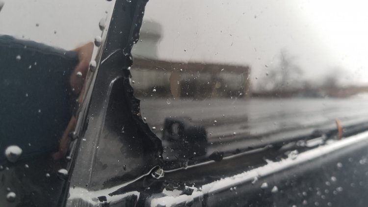

  5. Here are a few more pics. The whole outside of the window is falling apart and the lower corner as you can see fully blew out.
  6. Yeah, thankfully! It is always running while the truck is running. I talked to the dealer and they said while they never saw it themselves they heard of this issue. He's talking to his district manager if they can help me out. I'm 3 years and 1 month of ownership and 43k miles, so just outside of factory warranty. I do have a 3rd party warranty and i'm sure insurance would cover it 0 deductible, but I'd rather ensure OEM glass if possible from the dealer.
