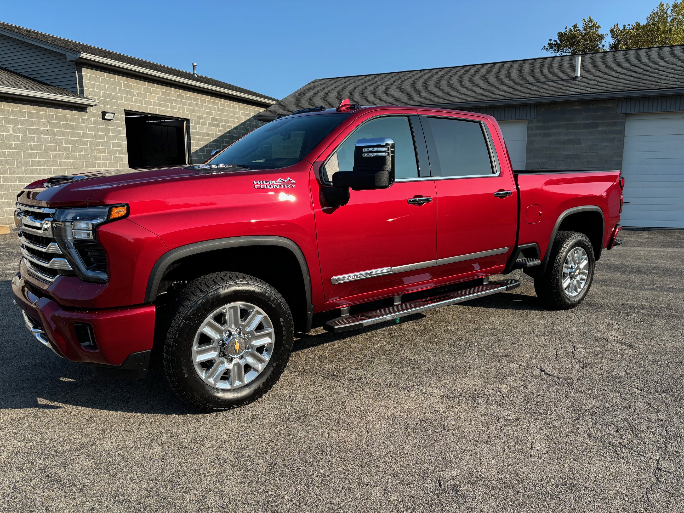

thanks , i first saw the wheels on a high country back in February at the Cleveland auto show, i thought they did a good job on the design. simple, nice and easy to keep clean. they will look great on your new 24....
yes, luckily it was built in flint, only 4 hours from me, was afraid if it was built at Oshawa shipping time could be unknown
