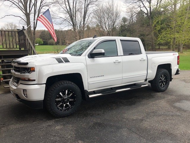

  3. Moto Metal 970's 18x9 with 18+ offset BFG K02's in 285/65R18. No rubbing anywhere. Even at lock both directions. I just have a 2" level on the front. I know they are not real big tires but I am really happy with how it improved the looks of the truck. Front tires are just even with the fender lip now, rears are tucked in a tiny bit.
