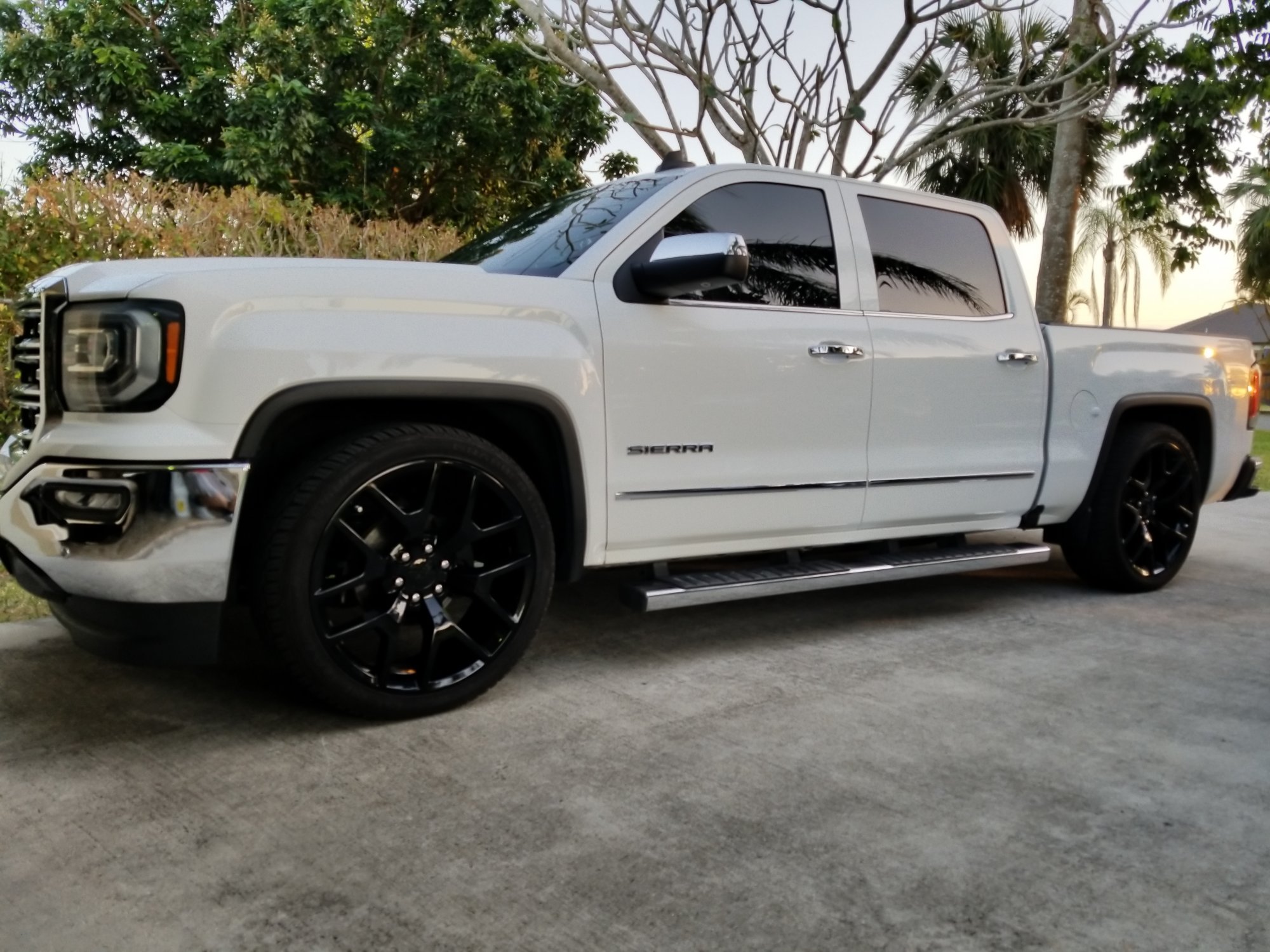

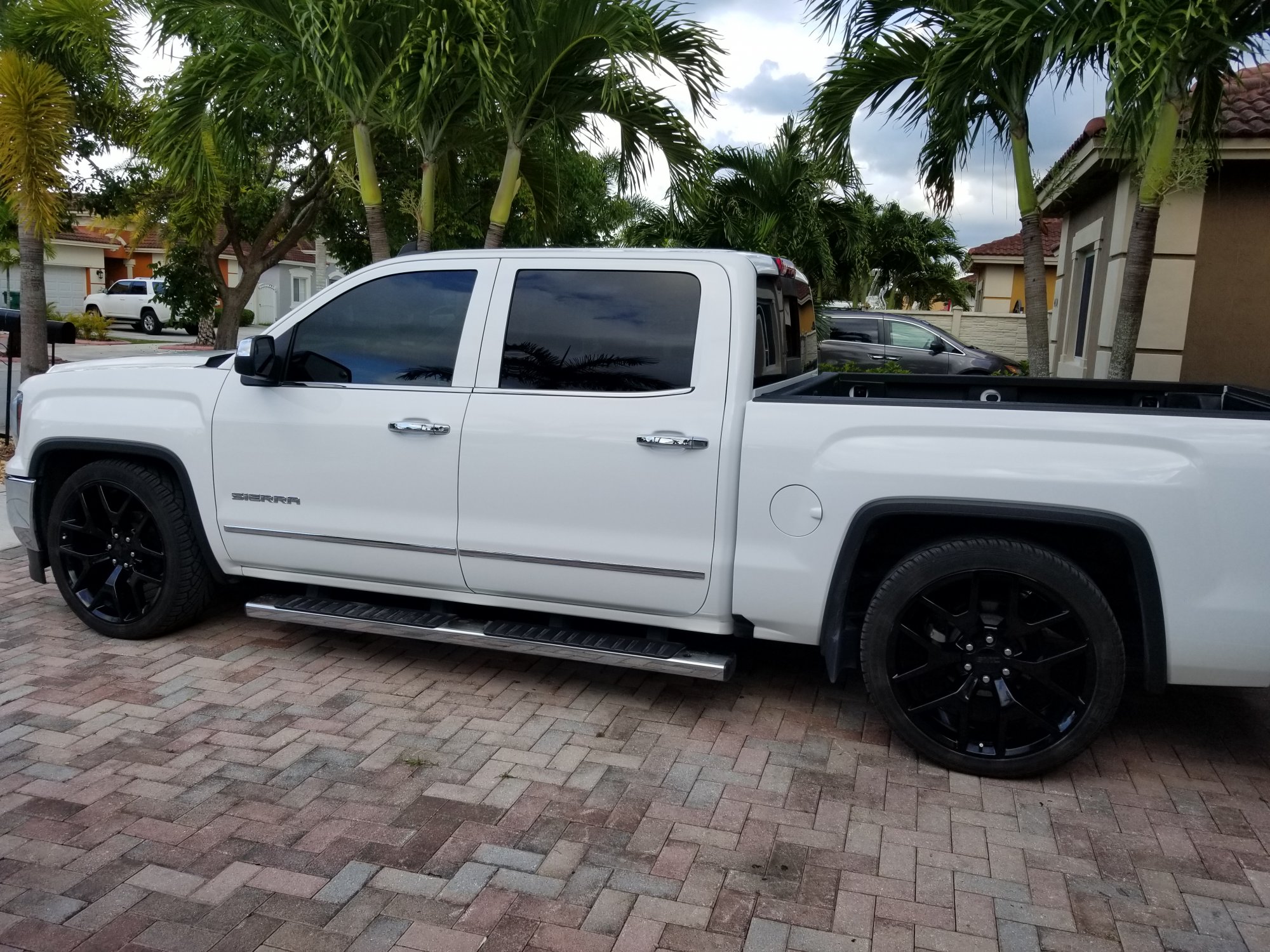

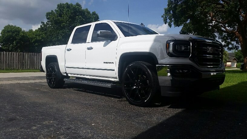

  4. finally got my drivers side front clunking noise issue fixed, by installing belltech front lowering struts part#25004 and also reinstalling the stock springs and removing the drop springs that came with my CROWN lowering kit. truck is riding a lot better. the only issue i have now is, that im getting more front end rubbing when wheels at full lock, than before due to the fact that the truck is sitting a little lower than before. I want the truck sitting level, so now i have to address that problem. either lower the back so more or raise the front a 1/2 inch. THIS IS BEFORE

  13. here are before and after pics. also got the drive line vibration issue fixed
