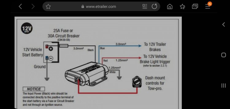

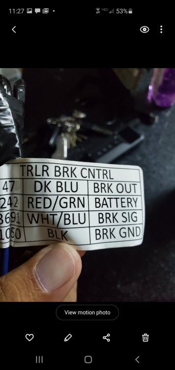

  2. I decided to buy a redarc tow pro elite for my 15' chevy 1500. I was originally going to go with another brand that had a plug and play wiring adapter so that i didnt have to deal with the one that came with the truck but i read thats not possible with the one. Can someone help me through the electrical part of this? Are the listed items below correct? Also can someone please clarify what to do about the 20 amp fuse/30A breaker/ positive battery terminal? Also, should i use electrical tape or shrink tubes? Truck oem wiring harness Dk blue - brakes out Red/grn - battery Wht/blu - brake signal Blk - brakes ground Redarc brake controller Blue - to 12v trailer brakes (goes to dark blue?) Red - to 12v trailer brakes light trigger (goes to wht/blu?) Blk - 20 amp fuse or 30A circuit breaker THEN to battery positive terminal? What? Lol (red/green?) White - ground (goes to blk?)
