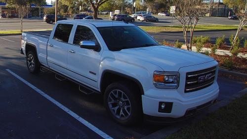

  1. Here's mine...2014 All Terrain. The photo was taken with my drone.
