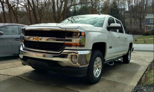

  2. Better profile pictures, still has the small 255/70 stock tires. The 275/70 18s will look nice.

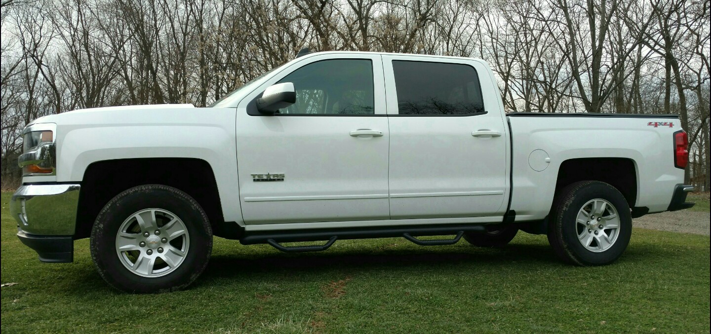

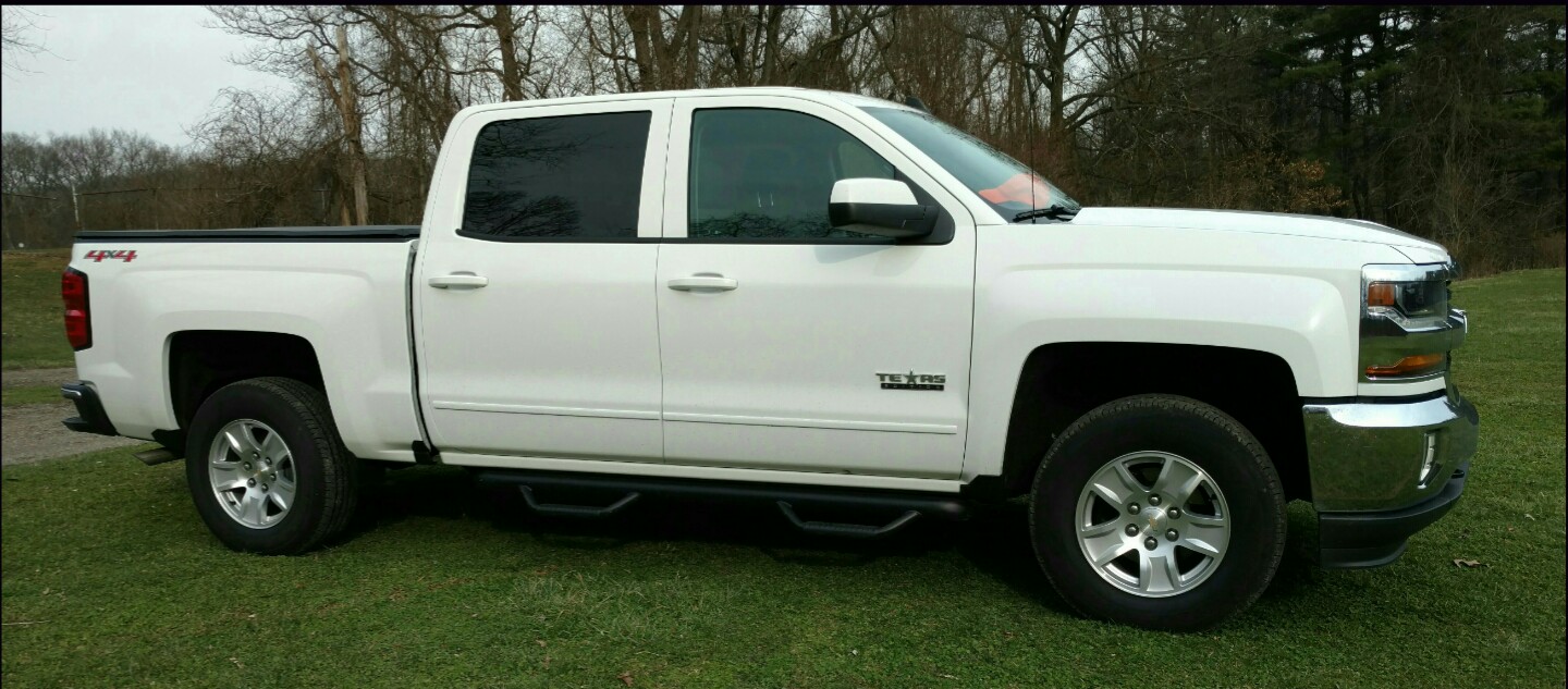

  3. Hard to get a good pic, very steep driveway. If I'm out today I'll get a side profile. Lowest setting in back, third up setting in front. Looks level to the naked eye. Measures out to be in inch lower in the front. These shocks eliminated a ton of the body roll and got rid of the bobble head effect going over small bumps at odd angles. The ride was stiffer at first but after 5k miles it's a softer ride than when I came off the lot.

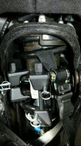

  4. Thanks for the suggestion. Tried my hardest to be "safe", picked up some compressors at pep boys. There just isn't enough room to get them in the right spot without dropping the shock. A couple clicks with a makeshift endless ratchet did the trick. Maybe the most unconventional thing I've ever done to a vehicle.

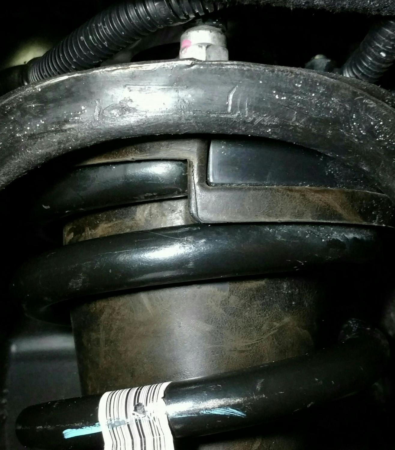

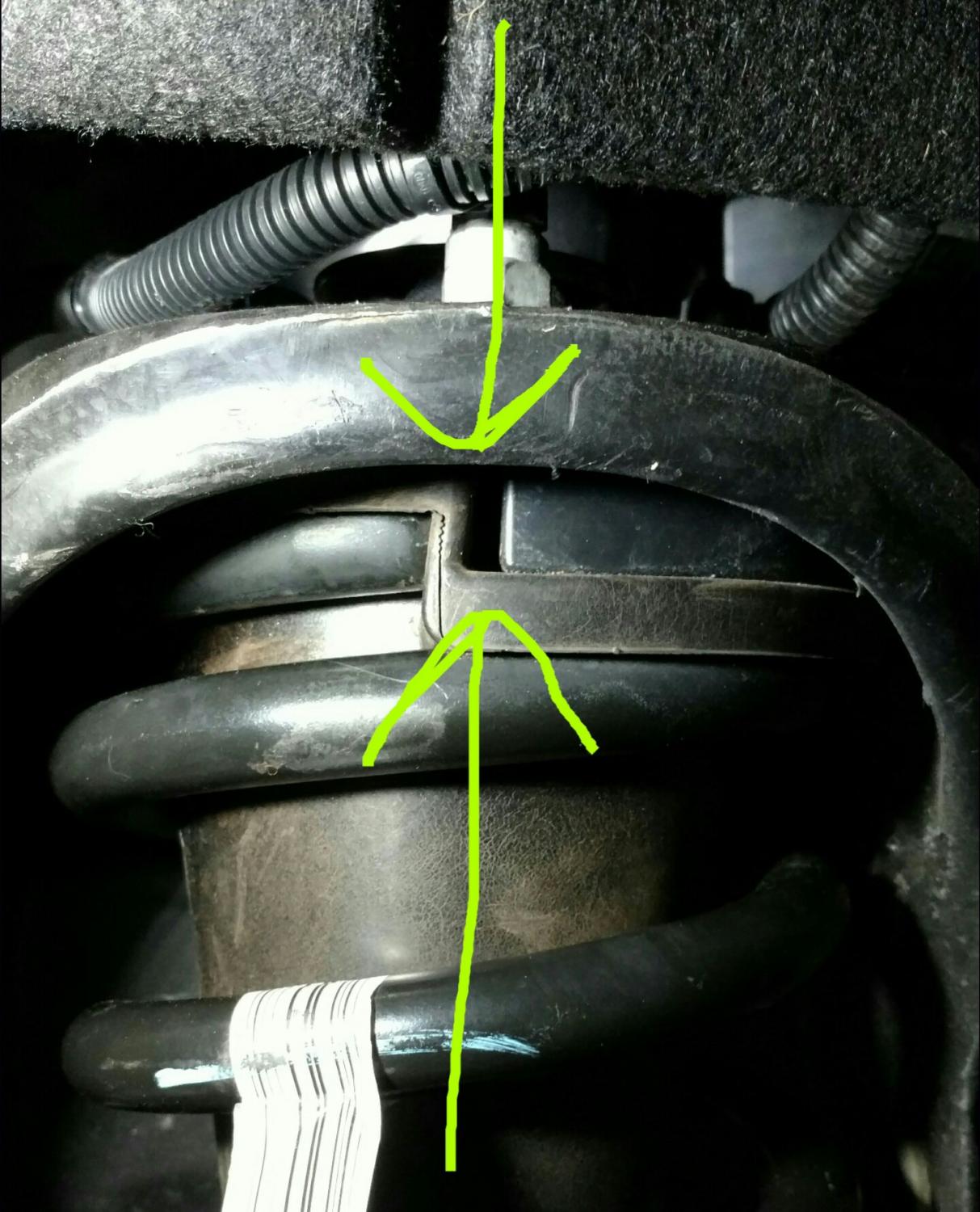

  5. Just installed 5100's in all corners. I don't have a spring compressor so I had a local shop install the front's. When I got home I noticed this gap by the upper spring seat. Any suggestions on a way to rotate it into place without removing and compressing the spring? I'm sure it's probably unnecessary but I'm a little ocd and I know this will bother me until I fix it (next time I buy a compressor and do it myself from the start).
