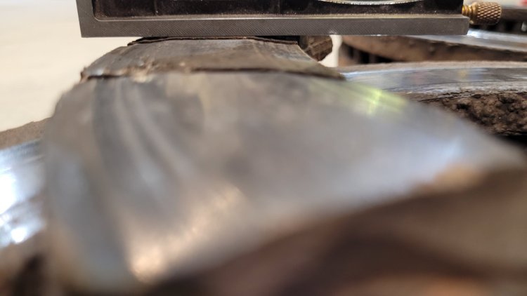

So a six year, 42k mile update to this, yep the brakes always have weak. Just now getting around to figuring out why. They were down about 50% in contact area on the front. Rear looks ok. -

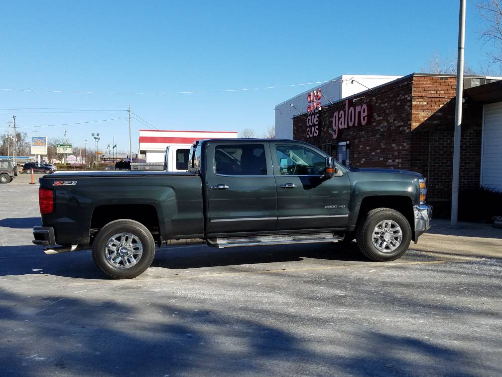

Like these? Or like these? I really like the protection of the ones on the 98, and I like the look of the ones on the 17. I don't like any variations of tube step or power step. Sent from my SM-G930V using Tapatalk -

After picking up my dirty truck on the 4th, parking under my carport, washing it on the 6th, parking it in the garage until the 9th, it finally saw the bright sun! To my dismay there are dents all along the top of the passenger fender. It looks like the guy changing the engine oil must have had a big belt buckle, tools in his pockets, or something. Now I feel like a complete **** for not washing, drying, and inspecting the truck front to back before signing to pick it up. I don't feel like even facing those guys again, so I stopped by a gmc dealer to get a quote on paintless dent removal. As I sat down at the service advisor's desk, I looked over at my rotor and something looked funny. The out side of the rotor is all new machine marks, save for two little strips where the brake pads have been contacting. So now I have to fix dents, but new brake pads, and ensure that the calipers are sitting square with the rotors. I am so over this flimsy piece of sheet, that I sent the letter to chevy corporate, and started a claim through BBB. It will take some sort of miracle for me to get another new 17 GM truck. Another bonus to this "New Road" I've found, is that my grandfather gave his life due to emphysema working on asbestos coated pipes in Flint Truck and Bus ('52-'85). Sent from my SM-G930V using Tapatalk -

So, I took the risk on the raptor board. They help complete the grandpa look that I am going for. Initial quality - ok Mounting - ok Ingress - ok Egress - rubber pad is a little too far forward for left heel to catch. -
