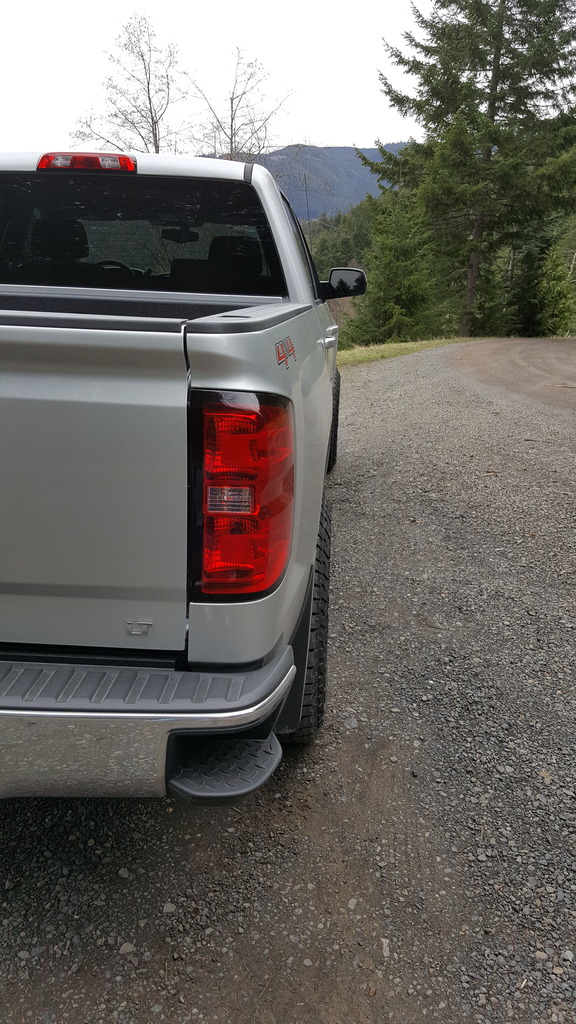

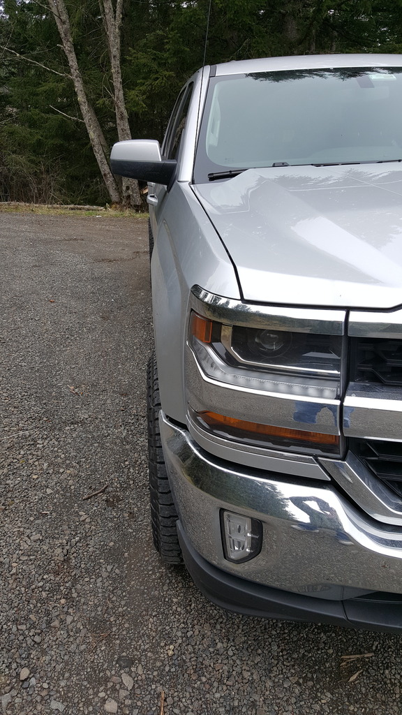

  5. You could just do the 2" front level and You would end up about 3/4" higher in the rear after everything settles out.

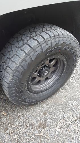

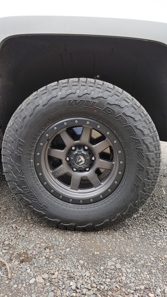

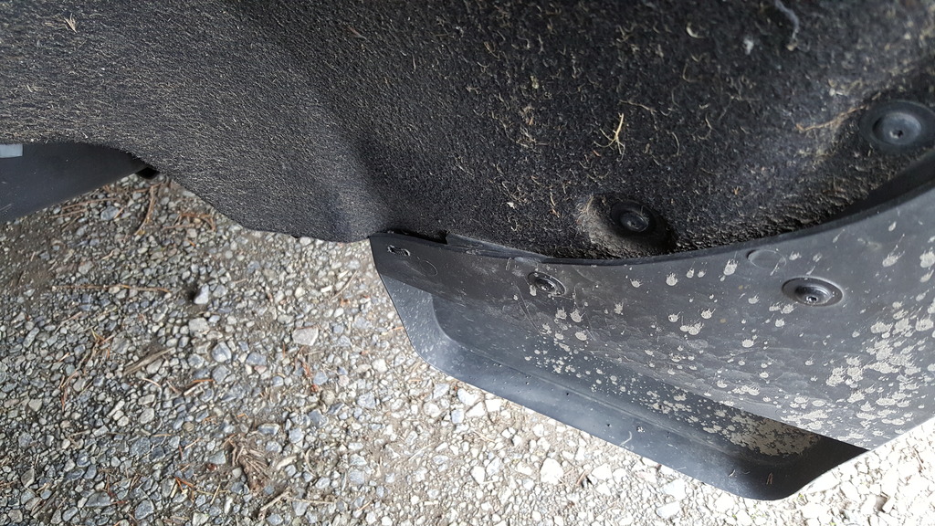

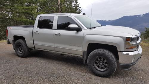

  6. I already posted in Wheel / Tire thread but I figured I'd post it up here as well. Fuel Trophy wheels 17x8.5" -6mm offset and Tires are Falken Wildpeak AT3W 285/70R17 ( 33x11.5" ). I also installed a Rough Country 2" leveling kit. There was slight rubbing on front drivers side at full lock in revers. I used a zip tie to pull back the inside corner of the mud flap and now there is no rubbing at all.
  7. Fuel Trophy wheels 17x8.5" -6mm offset and Tires are Falken Wildpeak AT3W 285/70R17 ( 33x11.5" ). I also installed a Rough Country 2" leveling kit. There was slight rubbing on front drivers side at full lock in revers. I used a zip tie to pull back the inside corner of the mud flap and now there is no rubbing at all.
  8. I agree with you MicahLo I dont think your tires look to small either. I think they look great!
  9. Looks really good! Any rubbing at all?
