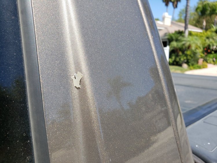

  3. Well, I know this is an older thread, but add me to the club. 2015 Sierra 1500 in Bronze Alloy Metallic. I just noticed peeling today near the window on the driver's side rear door. It's approximately 1/2" in diameter. Considering age and mileage of the pickup (125K), I don't expect any help from GMC as it relates to warranty. I see a class action suit has been filed about the issue in Florida, so I've inquired if the firms have any advice. If there is a newer, more detailed thread, I apologize, and I will look further. I just landed here with a Google search about the problem. If anyone has new pointers, it would be greatly appreciated.
