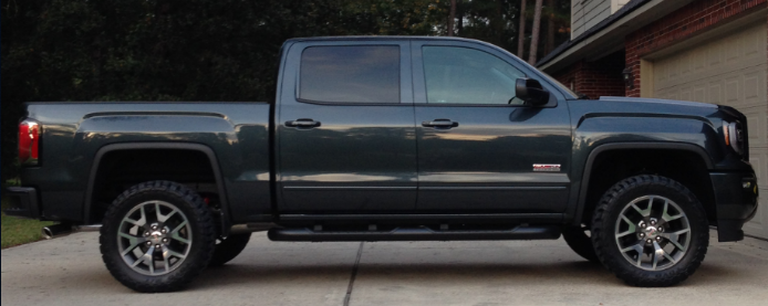

  2. It could be that the All Terrain wheels are different than some of the other models. I measured my studs and measured the pockets, then did a little math. I would have gone with more narrow spacers if the studs were shorter - I didn’t need to go that far out to clear the UCA’s , but now I’m glad I did. Thanks, I’m happy with how it turned out.
  3. You can use 1.25” spacers without trimming the studs if you keep the OEM wheels. The pockets in the OEM wheels are deep enough. From my measurements, a 1.25” spacer is the limit without having to trim. Not wanting to trim the studs is the reason I went with 1.25” - didn’t want to trim either. Your 1.5” spacers will work fine if you keep your stock wheels and they have the pockets. Not sure if all the OEM GM wheels have them.
  4. Yes, they are the OEM wheels with 295/55R20 Toyo Open Country M/T’s. I also have 1-1/4” Bora spacers installed.

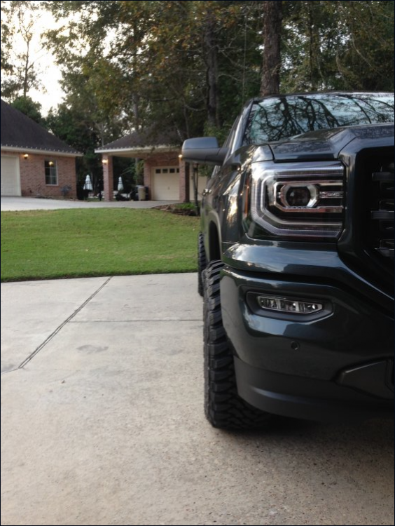

  9. Thanks, man. Next on the agenda is clear film on the rocker panels and a tonneau cover. After that, I'm calling it a day..............for now

  11. A few more if interested. One other thing - If you install the RC lift with the stamped UCA's, your truck will ride stiffer up front due to the preload the spacer puts on the spring. It doesn't really bother me, but it might bother some.
