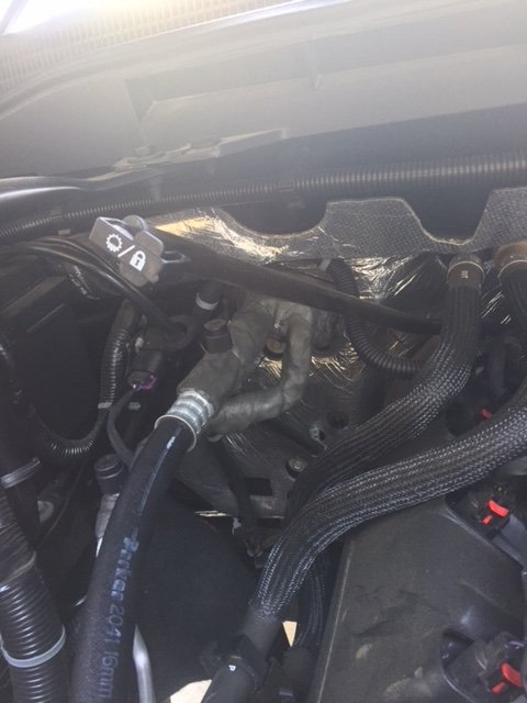

  5. Update on A/C noise 3 weeks after installing the duct seal around lines (see pictures above) outside where the lines enter the firewall the noise has disappeared, gone, quiet. I never realized the noise at low speeds was also there at any speed because now the Truck is much quieter all the time! Finally I love my Sierra and would like to thank Jim again for the simple common sense fix. I hope GM reads these post so they can save others from total brain damage from the noise from their poorly designed A/C systems, not to mention my 5 service trips, unnecessary new compressor, new fan motor and rental cars they could have fixed it for less than $7 and probably saved hundreds or thousands of customers.

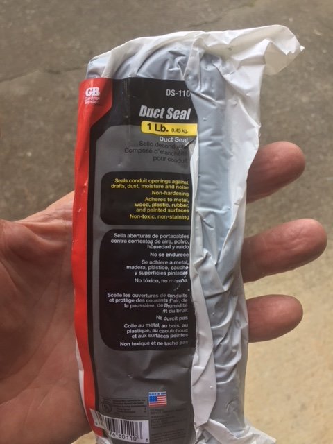

  6. My 2016 GMC Sierra 1500 has had a loud noise inside cabin and GMC service has tried everything to fix it, they new compressor and fan motor none helped. It has been in 5 times for repair but no one could figure it out. Finally on another post I saw a fix so I tried it and so far it has eliminated the noise. Cover the incoming metal lines outside under the hood with 1 lb bar of Duct Sealer (found it at Home Depot in electrical dept) form it around metal housing and tubes where lines enter firewall takes only a few Minutes to do. After 2 years of agony I could not believe that it stopped the sounds but it did. I will attach pictures of solution good luck!
  7. Thank you Jim, I tried the duct sealer bar from Home Depot as you suggested and so far it has stopped the AC noise in the cab. I can't believe GM can not figure this out but you did, you're a GENIUS! Maybe GM will give you a job fixing their un-fixables lol I will attach the pictures of my fix because it is different set up from your pictures but thanks again for the suggestion and solution to the most annoying noise.
