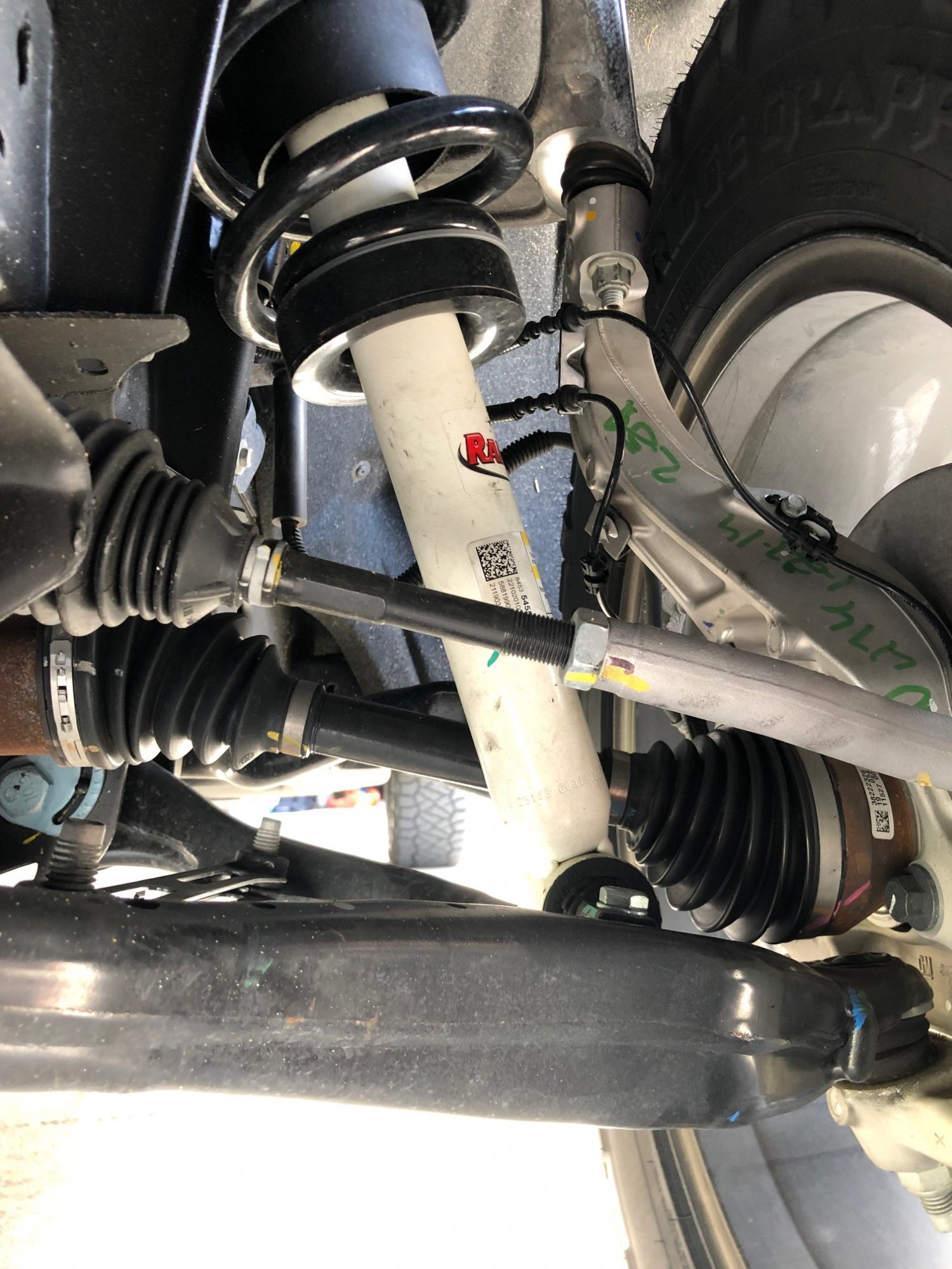

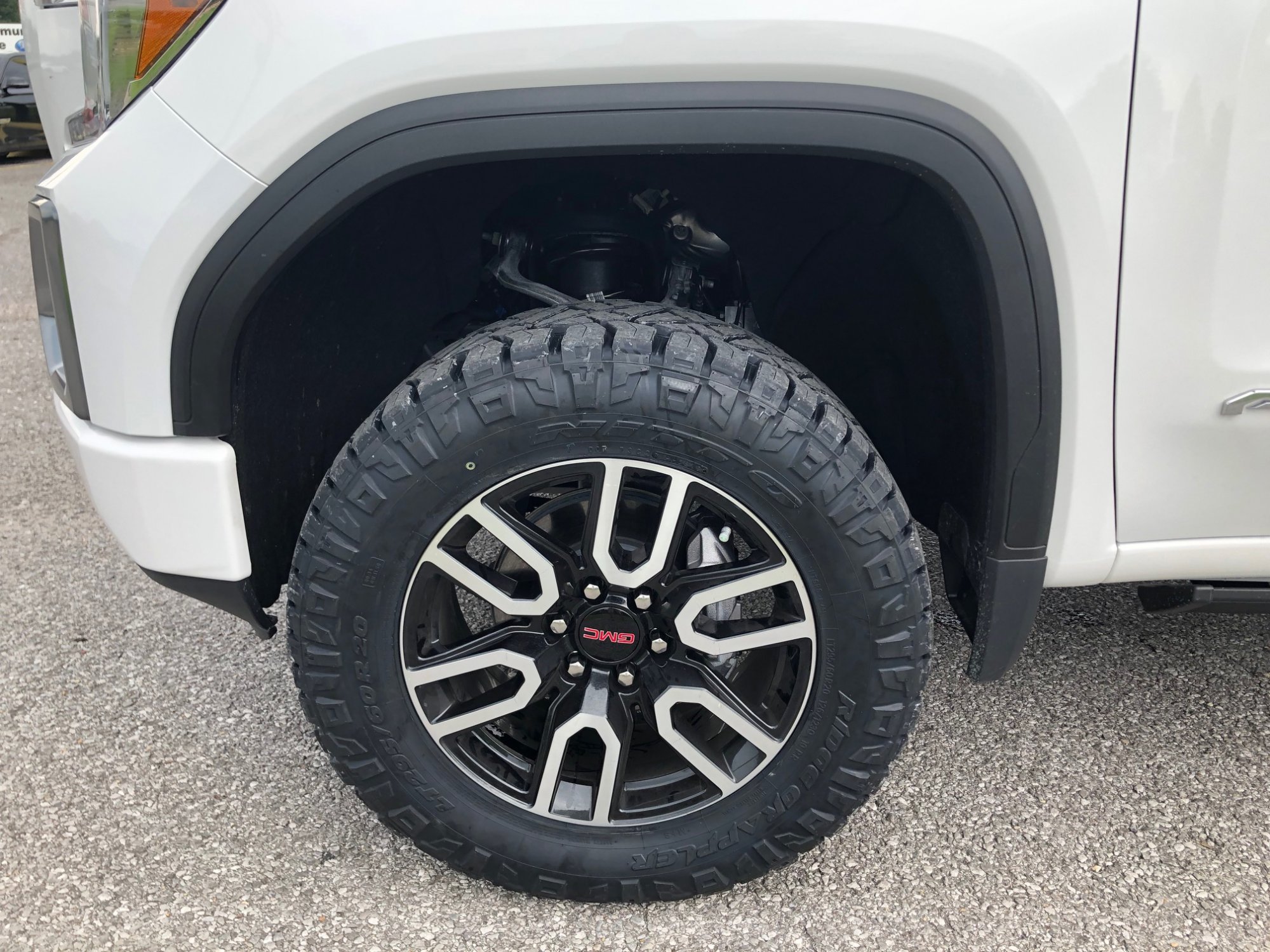

2" Rough Country 1318 level 295/60R20 (34" x 11.7") Nitto Ridge Grapplers View of CV angle and two half-decent views of upper ball joint (tires are straight in top photo, and wheel is at full lock in the second photo). -

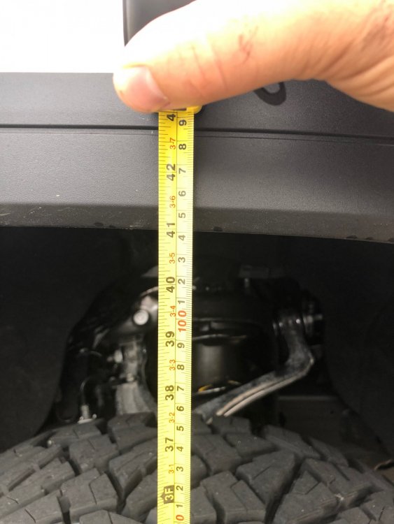

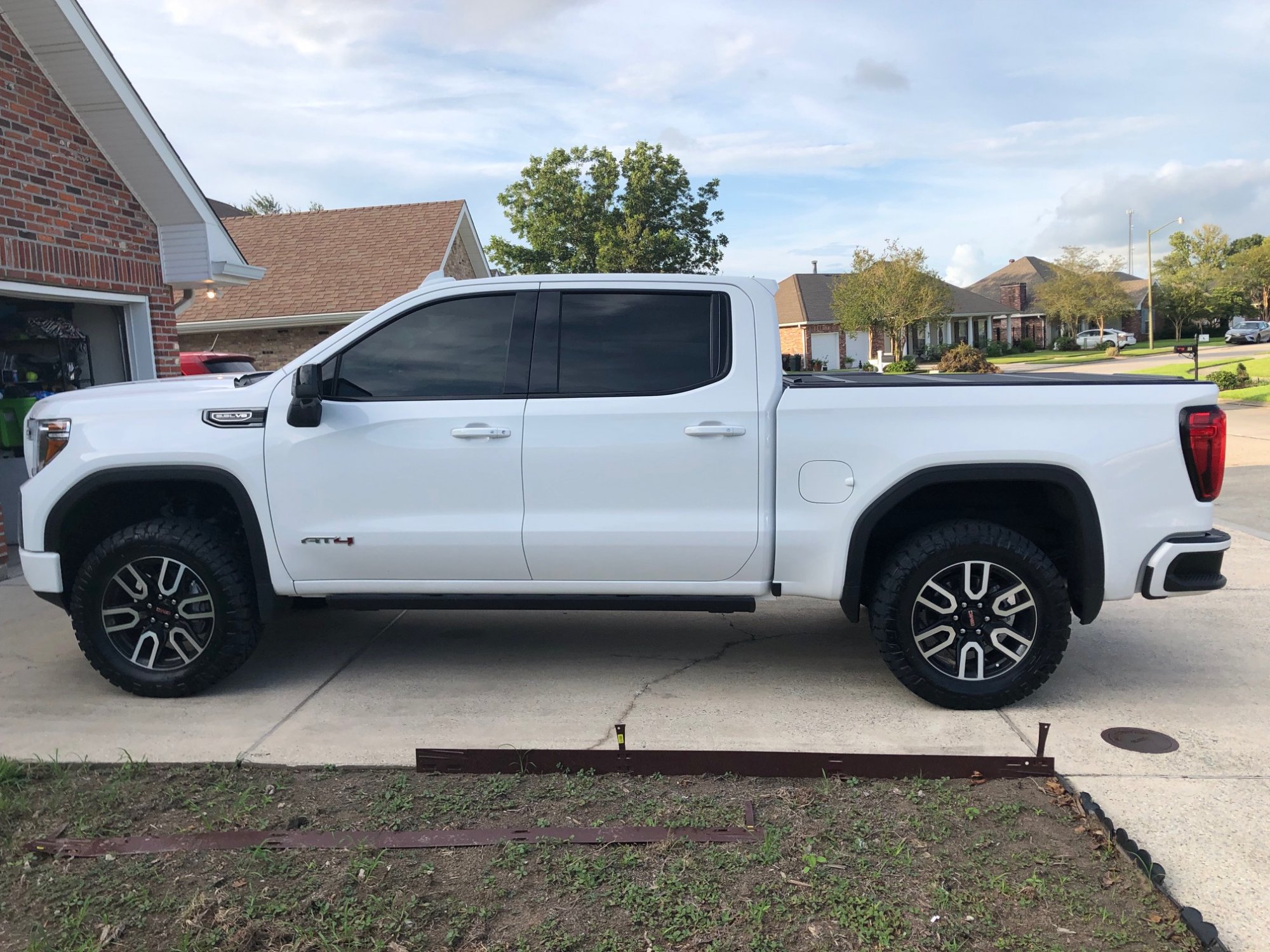

2" Rough Country 1318 level 295/60R20 (34" x 11.7") Nitto Ridge Grapplers The truck is perfectly level. -
2019 Sierra AT4 level/wheel/tires mod
thsoccer3 replied to Razorrick's topic in 2019-2026 Silverado 1500 & Sierra 1500
2" Rough Country 1318 level 295/60R20 (34" x 11.7") Nitto Ridge Grapplers AMP Powersteps BAKFlip MX4 bed cover I have no rubbing, but it is very close on the upper control arm. The ride has not changed, and the truck is perfectly level. I am very impressed with the upper ball joint and CV angles. More pics to follow. -

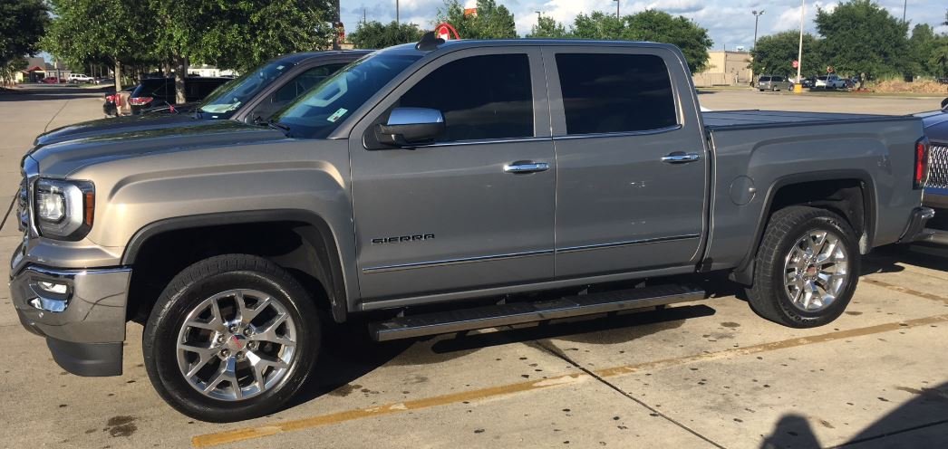

I installed my Motofab 2" front level myself last weekend. It is the upper strut "doughnut" style spacer. I had an alignment done by the local tire shop the next day. Initially, everything rode well and nothing was making noise. Now, 6 days after install, I hear a knocking style noise when I turn the steering wheel at slow speeds. I can only make the noise happen while traveling very slow in parking lots and turning the wheel almost to full lock. It is usually 2-3 knocks. It happens when turning the wheel and then happens again while straightening out - almost as if something is shifting, and then shifting back. I re-checked tightness of all components that were loosened for the install (tie-rod, sway bar, upper and lower strut mount bolts). Because this only happens at extreme turns during slow speeds, I am wondering if it is the tie-rod connections. Possibly they are over-torqued? Does anyone have a recommended torque value for the tie-rods and any other suggestions on what may be the culprit?
