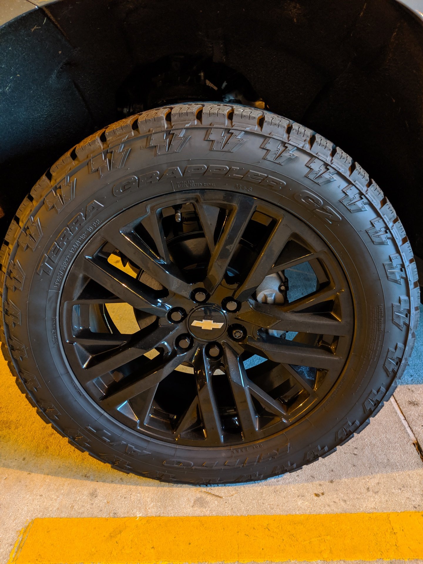

  1. Just to give some reference, here's an LTZ with 285/55 Terra Grappler on 22s with GM 2" lift. No rubbing with clearance for more. Ridge Grapplers would fit well...

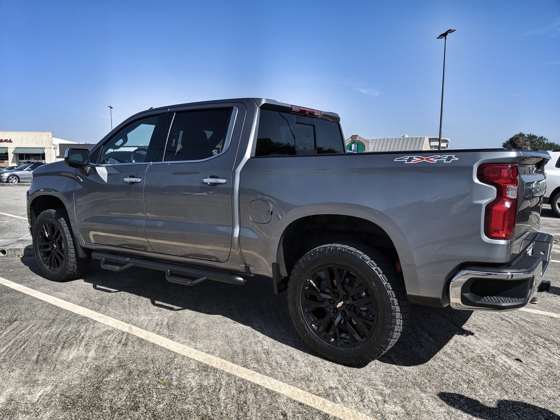

  2. LT285/55R22 on s LTZ with Trail Boss lift. No rubbing at full turn. W

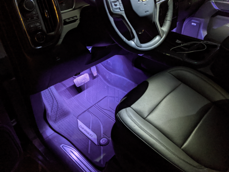

  3. Wrapped all the wires with a zip tie and stored withing the two kick panels. Zip tied the control on the driver's side to the holes in the plastic cowling, used a breadboard kit male to stick into the grey wire on the bcm on the first plug near the driver, pin 23, to add the light option. After turning the lights on...
  4. I put in the OPT7 Aura Pro x6 with door option. Just a note, for the door option to work, the lights must be switched ON in the app. It just changes the color to white upon entry. I expected the lights to turn off after some time, but they stay on, until turned off manually with the app. I used a free blade on the driver's side fuse block, wired in a fuse holder, and soldered it to the direct wire cord included in the kit. I couldn't use the delivered fuse holders with the 3 prong fuses Chevy is putting in these trucks. Easy to run the wires in the wire tray under the door sills. Door option below...

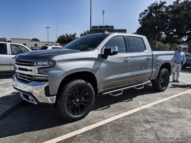

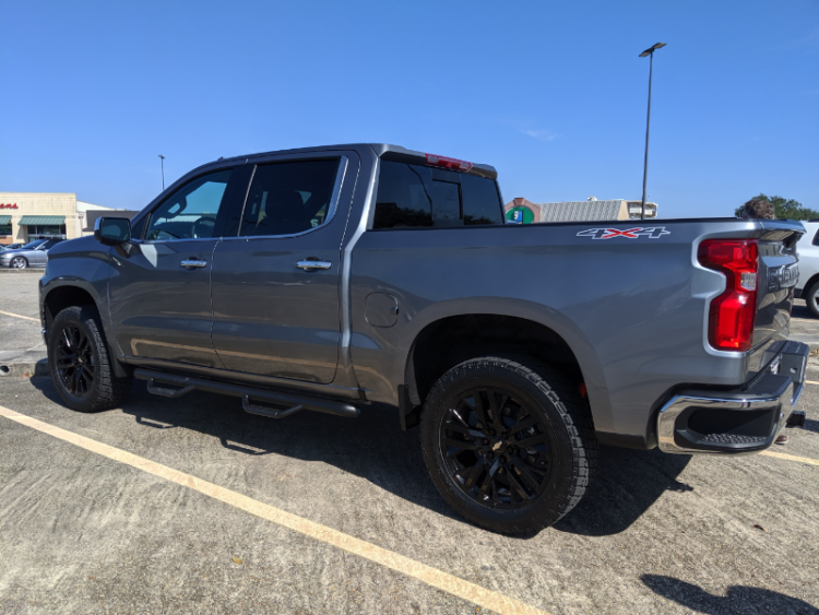

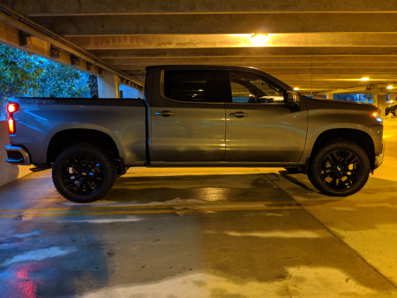

  5. 2" GM lift on an LTZ. Thanks for the compliment.
