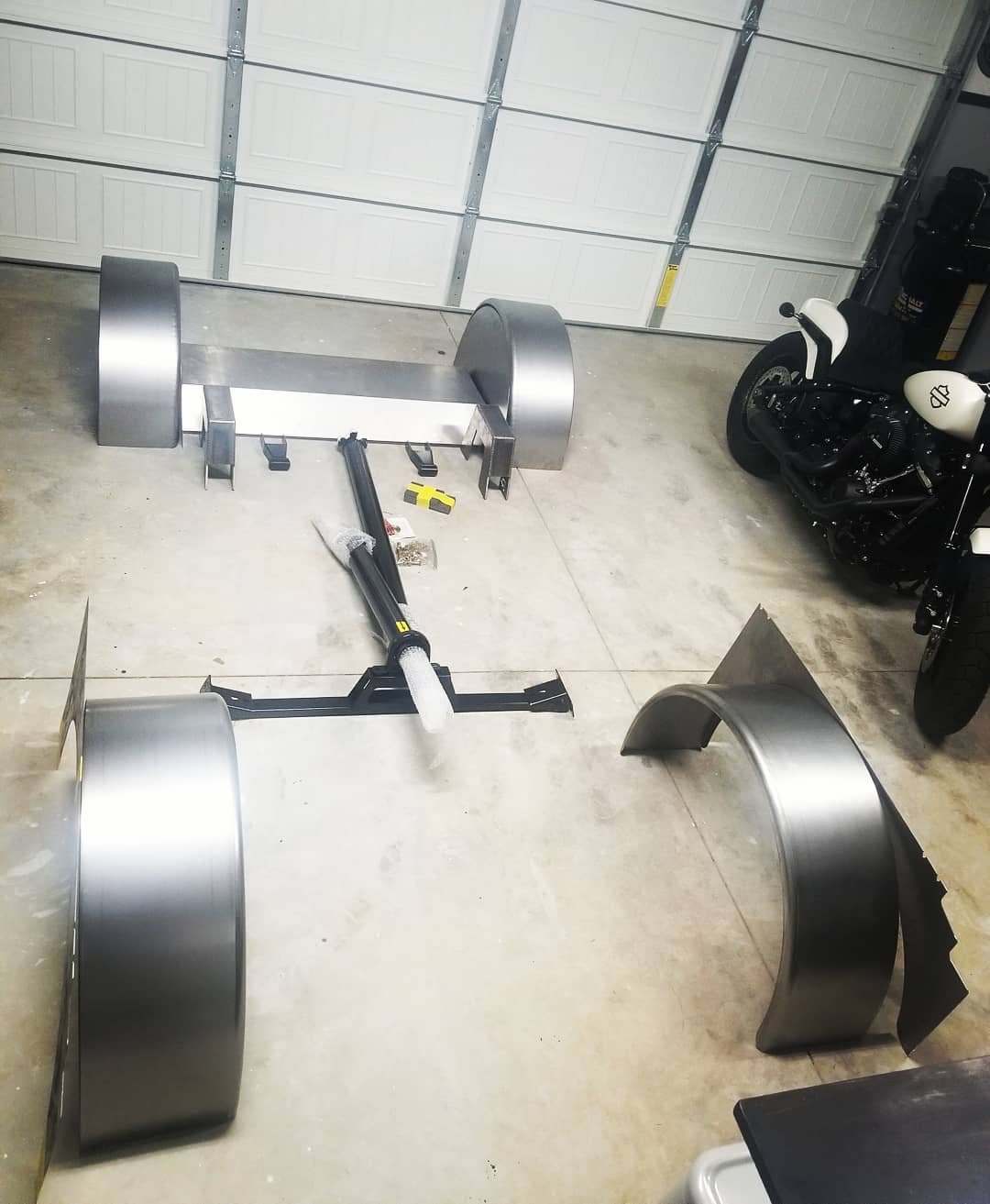

  12. Well I've had the 2 piece driveline for a couple months now. But finally was able to install it with help from friends. Honestly never having messed with a driveline before I would not have been able to do it by myself. We ended up pulling the trans shim that was required for the 1 piece factory drive shaft for the drop kit to get our angle correct. After figuring that out it went smooth and easy. Drive shaft came from performance drive shafts out of Bakersfield ca. It came with a bolt in crossmember. Spicer u-joints and was like 690 bucks shipped to my front door. I did get a before photo that showed scaring on the driveshaft. But once we got going I forgot to get pics. Anyways I got a couple horrible photos later on. (Cant upload do to size) sorry not computer savvy enough to resize Next weekend is tubs, shock mounts, monster notches and dropping her more. I'll keep u guys/gals posted

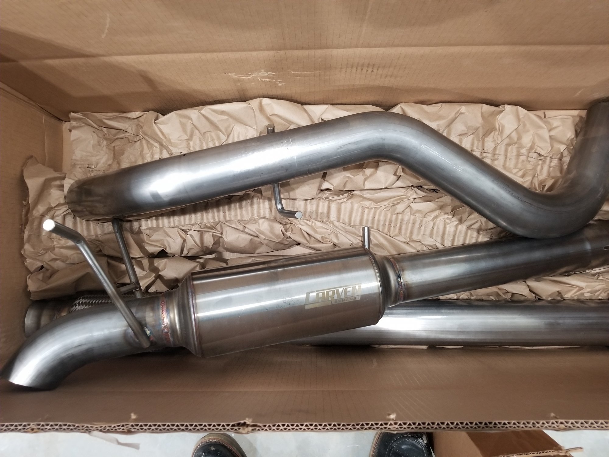

  18. I ordered the stainless carven cat back exhaust dump on black Friday and installed today. The sound is low and no pop on decel. I'm very pleased. And actually I think they messed up and sent me the entire exhaust instead of just the cat-dump. They sent me the entire mandural bent over the axle pipe as well. That kit was 779 I paid 329. So sounds great. Idk how to post videos but my instagram name is 17gmclowlow if u guys want to hear it. Stock 5.3l sounds good.

  23. Sorry. Been busy. I returned the under bed notch and ordered the monster notch and front and rear tubs. Going much lower than I first wanted to
