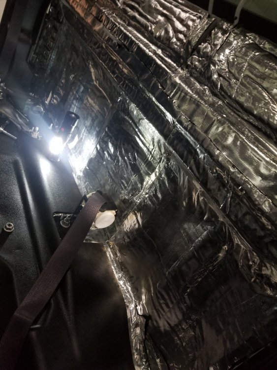

  5. I forgot to take pics of the floor in the back seat, But I used 8mm dynomat in the back of the cab/floor. Super easy and cheap. Longest part of the installation was stripping everything out.

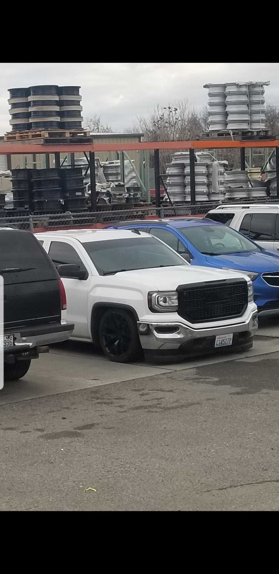

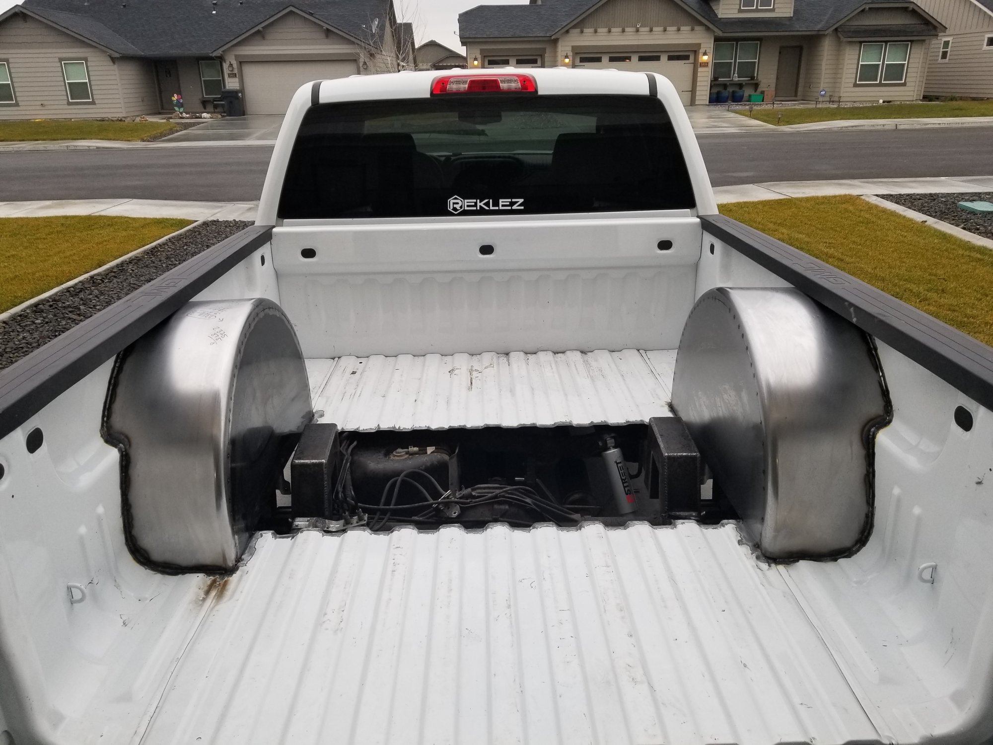

  10. Well after tons of off and on and fitting. This is where I'm sitting now. Just under 8" drop in the front and 9" in the rear. Its sitting dead even. Although even, its tucking up front and not in the back. So I may go w 24s in the rear to get the tuck. Then drop it another inch to make up for the bigger wheel. Static for now, maybe thinking of doing air ride. Not sure. It's just my daily. So not sure if I wanna deal w air ride. Rear tubs are done. Although I still have to weld in the dog house. Just haven't had the time. I'm running 265/35r22s and only rub up front when I hit a big enough dip in the road. Oddly enough I rubbed more when I had my 305/40r22s on my 3/5 drop. I'll be doing my front tubs this summer when I can ride my bike to and from work and the truck can be down for a while. Due to relocating the battery, coolant reservoir and fuse box as well as a new intake that will fit w/ the tubs. I'll be color matching the bumpers when I have the tubs painted. But hey... it's coming along.

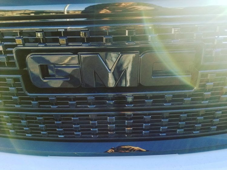

  11. Ami styling billet grille emblem installed. powder coated black. And matching the grille almost perfect. I think its a great product since all the abs material in black were well over 100 bucks. I paid 53 shipped with a 20% military discount.
