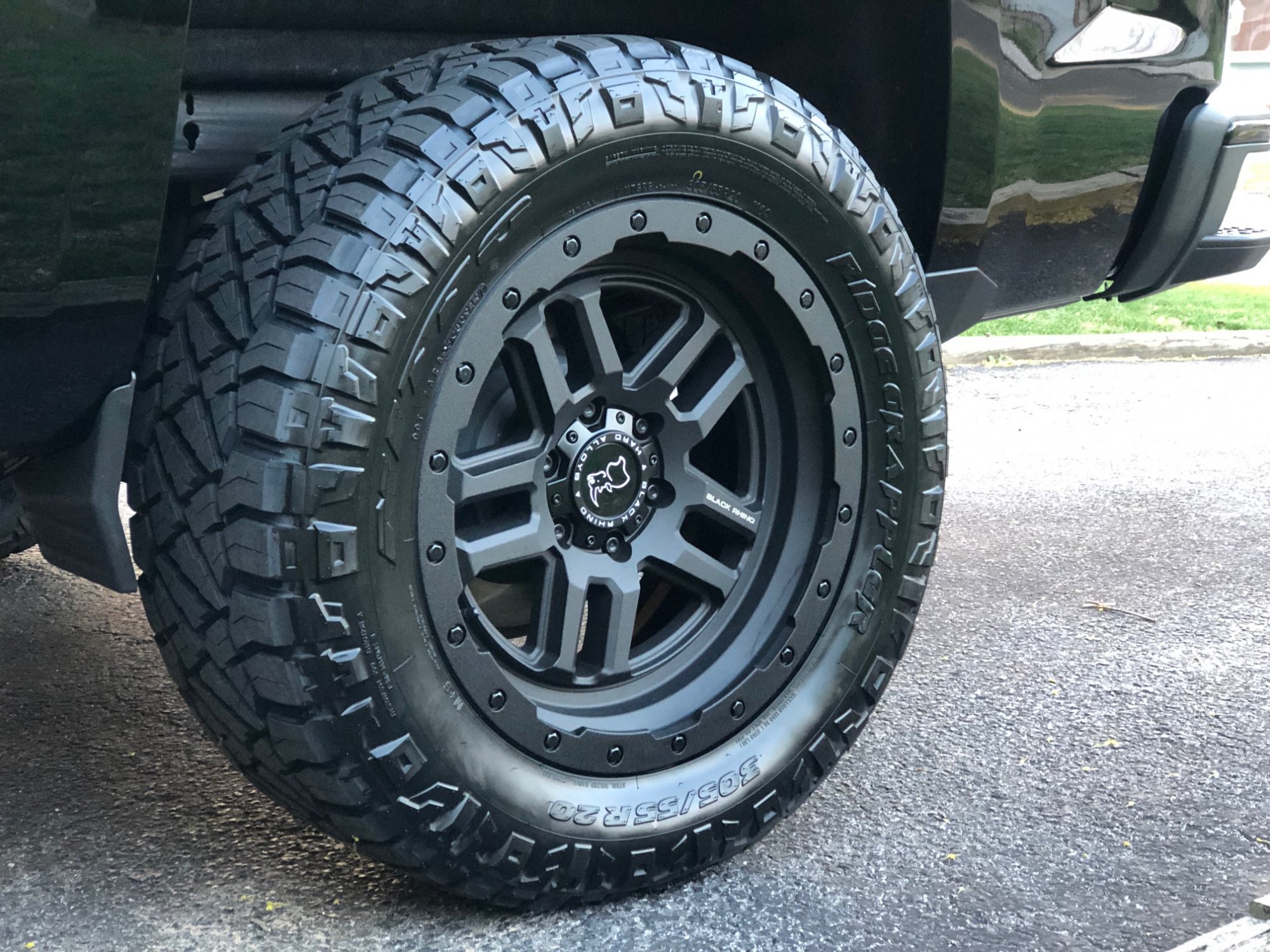

  2. Added picture of the wheel/tire setup. I love how they look. They have a textured finish that is almost impossible to get dirty. Just rinse them off and they are good to go. I wanted something other than the normal fuel wheel setup most people have.
