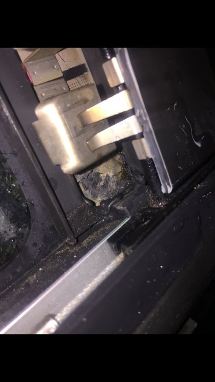

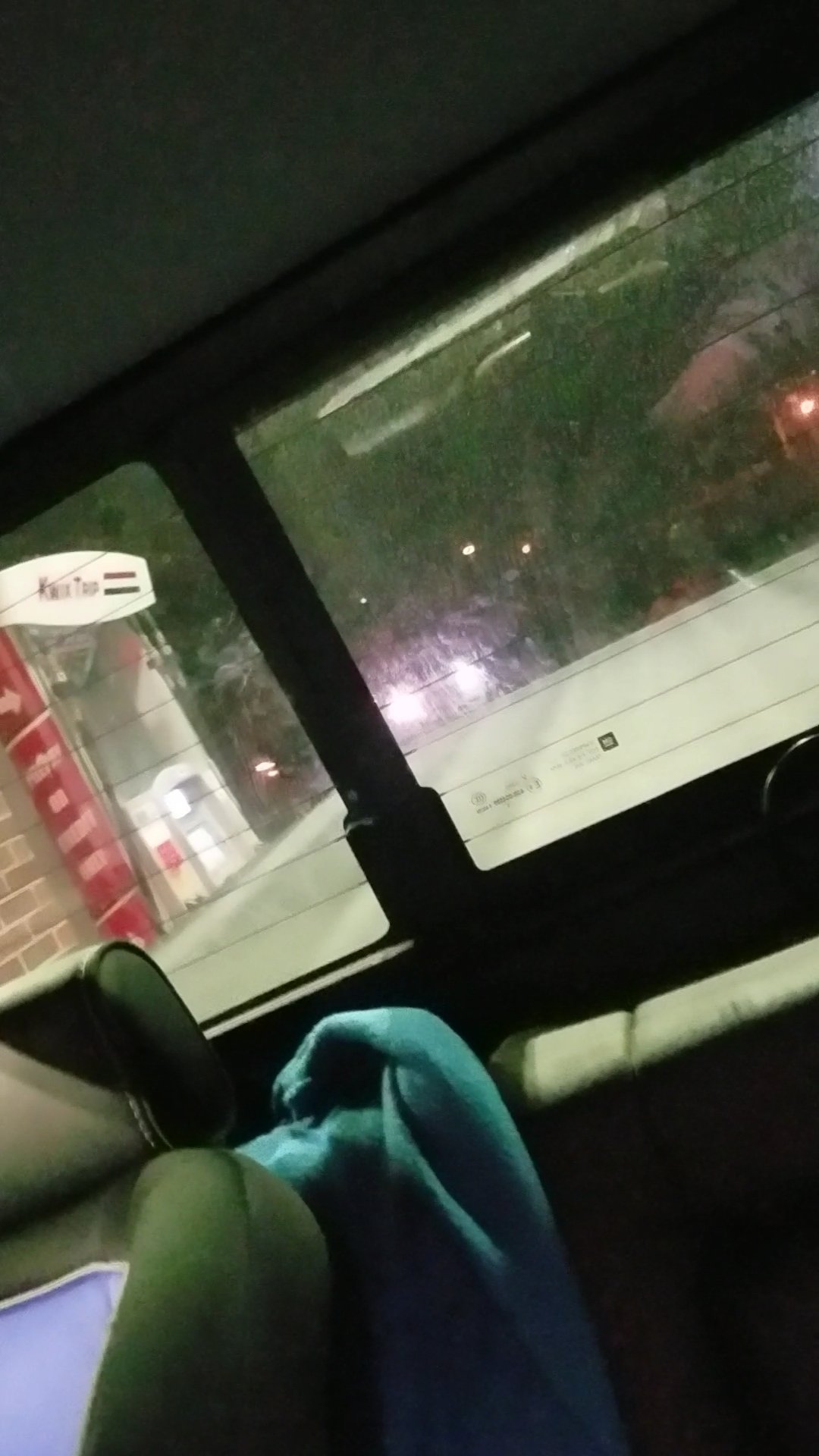

  2. So even though it wont let me post the video of the smoke. I took a screenshot of the smoke minutes before it shattered and u can zoom in and u see there is no chip! U can also see a little smoke easily mistaken for a dirty window. I will also post the pic of "point of impact" so u can zoom in to that spot of before pic. Also the dealer is about 15min away so the drive there could have caused that spot to chip off. The spot is right by that black contact box that was smoking. And glass guys said excessive heat could definitely cause that spot. Roseville GMC lost our buissness too. Google reviewing individual dealerships is a good way to let people know who the bad ones r because a couple peoples dealer actually helped them! Also glass is usually an exception to ur deductible. Mine covered it and state farm didnt care that it was caused by the truck i told them what happened too.
  3. Most full cover insurance pays for it. But they shouldn't have to! The pic i uploaded shows the melted connection the glass shop sent me the pic. I went to a small glass shop (not the one the dealer recommended) they did all the work to get it coverd by my insurance.
  4. "Point of impact" is the exact thing they said to me too, Its BS! It wont let me upload video(too big). But when paused u can clearly see there was no chip or crack in window whatsoever while it was smoking. See my earlier replies for more details and photo of burn damage the glass people found. What dealership? I hope everyone is using Google reviews on maps for bad dealership experiences, Maybe add link to this forum! Tons of people check google reviews.

  8. Yes defroster was on with auto start when this happened and yes its a sliding window the spot the dealer referred to as point of impact just so happened to be exactly where the contact for the sliding window is. this is the pic the glass shop sent me
