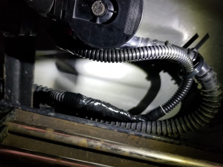

  1. Update: spliced in a new cable from Amazon using wire connectors, electrical grease and taped it up. Light is off.
  2. Yes, that scares the shit outta me... Going to lay down tons of mouse traps now... Thanks!
  3. Update: I was able to get it off, wow these things are a pain. First I used a pair of nose vice grips to grab the red tab and pull. As expected, that broke right off. Then I grabbed my full size vice grips, grabbed the outside of the plug and tore and twisted and it eventually popped off. Next step is to buy a new plug and splice it in.
  4. Update: I've tried pushing the connector in, wiggling it, pulling it out- all while pulling the red tab down and nothing budges at all. Is it possible it's locked up somehow or am I approaching this incorrectly?
