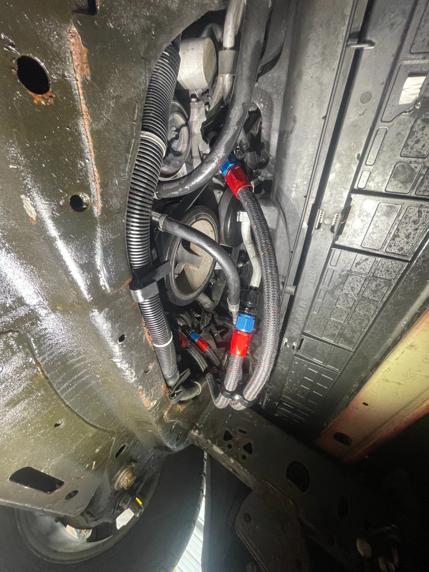

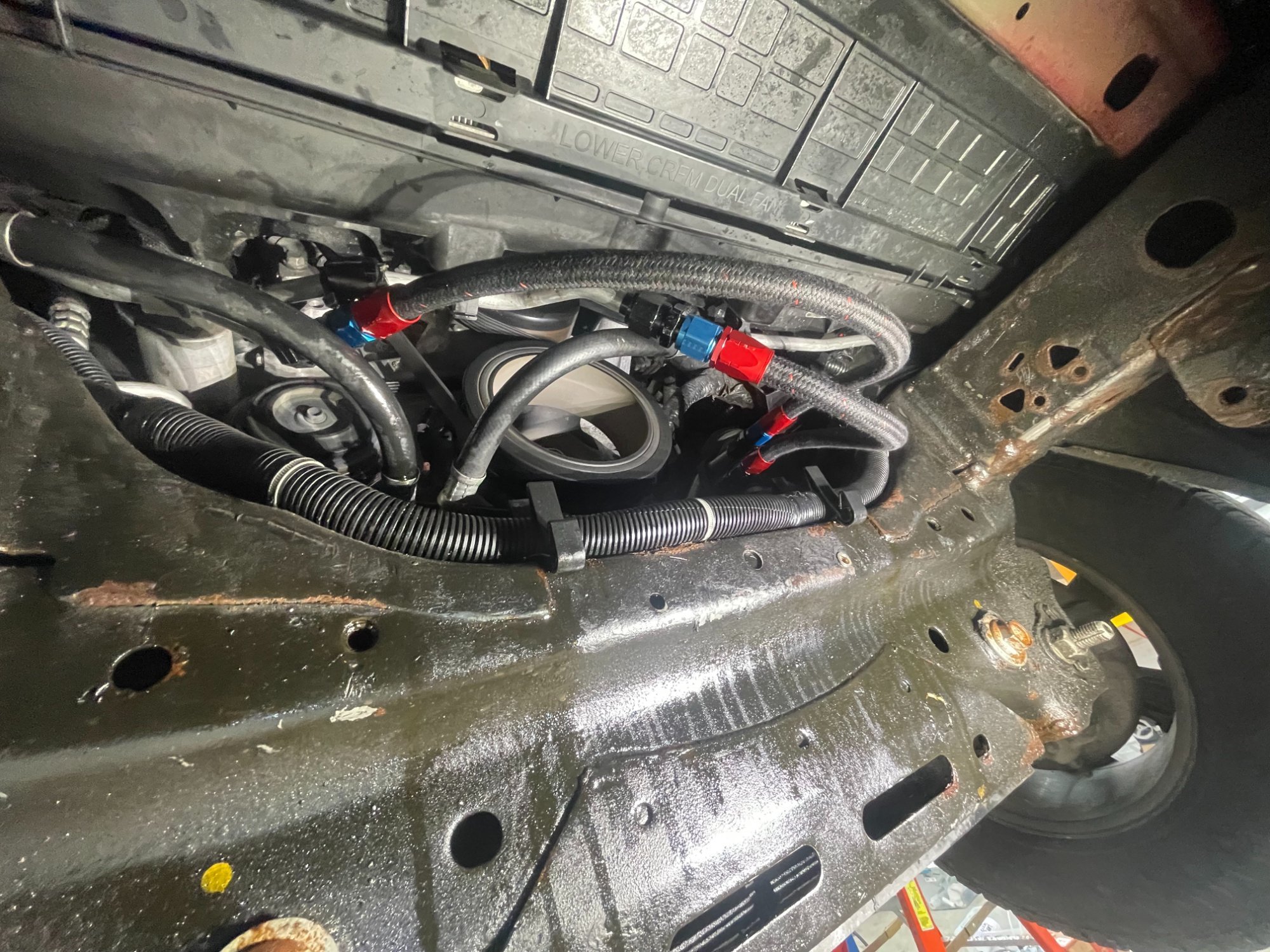

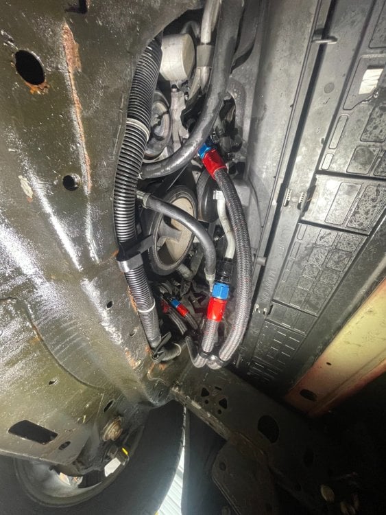

I didn’t want to replace with another set of factory lines given how quickly the originals started leaking, and I didn’t like the idea of clamping with no barbs either. I ended up cutting the factory lines just before where the flex line crimps were on either end and bought a flare tool and flared them (I took them off the truck for this) and used AN fittings and flexible braided oil line to make new flex sections. That was just over 2 years/30k miles ago and it’s still going strong. EDIT: attached an image of the parts I ordered from Jegs. -

Here's what I ended up with. I'd have probably put the joints in slightly different spots, but I kinked the factory lines trying to get them out before I decided to cut and reuse them, so I worked with what I had at that point. -
